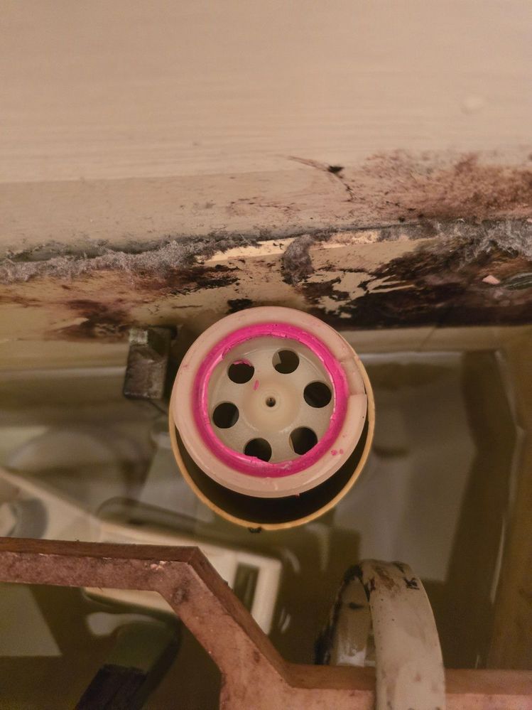

Please excuse the filthy inner of the cistern!!!
This is the o ring under the cap of my fill valve, does look like it’s disintegrated a bit, would you have replacements for this?

Hello @BeccaAnn
Thanks for sharing that photo of your inlet valve. The O ring I was referring to is actually on the piston arm not the base. Your base looks to be in good condition; it's the other part we need to look at so we can determine if the O ring and stopper need replacement. The kit you are after is the Fix A Loo ballcock 4 that suits Caroma inlet valves. This spare part needs to be specially ordered at the special orders desk. This is the most common replacement washer used on older Caroma inlet valves.
