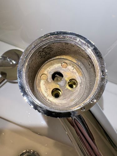

Thanks a lot for your reply. I think the cartridge is well seated as the nut was quite tight. I attached the photo of the surface, I have no idea if the surface is good enough for sealing. By the way, how can I check the O-ring of the tap body? Do I need tube spanner to fully dismantle the tap body? Thanks a lot!

One way to make sure that the ceramic cartridge is seating properly is to make sure that the two bottom guides line up with the depressions of the tap bottom. You'll notice that the ceramic cartridge that you have has two small protrusions at the bottom these are meant to guide the cartridge and make sure that it is properly lined up. At the bottom of the ceramic cartridge are two O rings, one for the hot and one for the cold inlet just make sure that they are present and that the surface is not damaged.
I propose re-installing the ceramic cartridge and making sure that it is seated properly. If you still get a leak when the cartridge is in the off position it is either the brass seat for the mixer is damaged or the cartridge itself is damaged due to overtightening. My recommendation in this particular instance is to replace the mixer tap as the brass seat can't be repaired. You can try using another new cartridge to test if the cartridge you have now is broken.
In regards to your query about dismantling the body, I don't recommend taking it apart as the repair effort is not worth it. The time, money and effort spent on searching for a compatible O ring body kit are better spent on replacing the entire tap with a new one.
