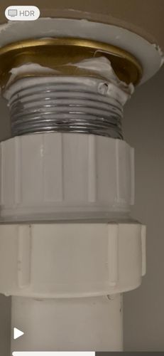

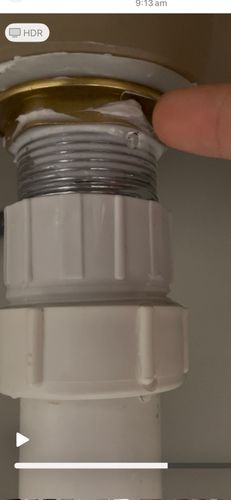

Hi everyone
I did DIY bathroom vanity replacement.
everything works well except this morning it’s small leaking from the pipe.
not sure what things to put it there.
please see the picture.
Re: How to fix leaking vanity waste?
Hi @dekeykunsang,
Generally, when a vanity waste is installed, a plumber would use Plumbers Putty under the part of the waste on the top side of the vanity. If you didn't do this, I would suggest removing it, cleaning up whatever silicone you have used and replacing it with plumber's putty.
Make a sausage with the putty and then sit it in a circle around the hole in the vanity. When the waste is tightened on, it will compress creating the seal you are aiming for.
