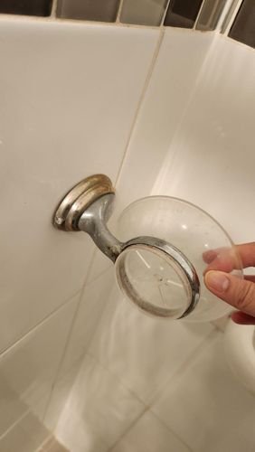

The soap dish twists round and round - should I put some sort of adhesive to secure it?soap dish twists round and round and round...

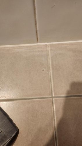

Lastly, there are a couple of pitted tiles (is that the right word for it?). Should I seal them up with epoxy or something?pitted tile

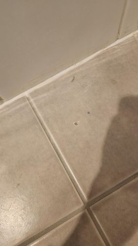

another pitted tile

I can't imagine many glues would adequately hold the soap dish in position in the shower. You could try some super glue or epoxy glue. Placing a small amount between the chrome and brass section could be enough to cease the rotation.
For the pitted floor tiles, it's more of an aesthetic issue than a problem you must address. You could paint the chipped area to match the surrounds better or seal them with the clear epoxy I linked above.
