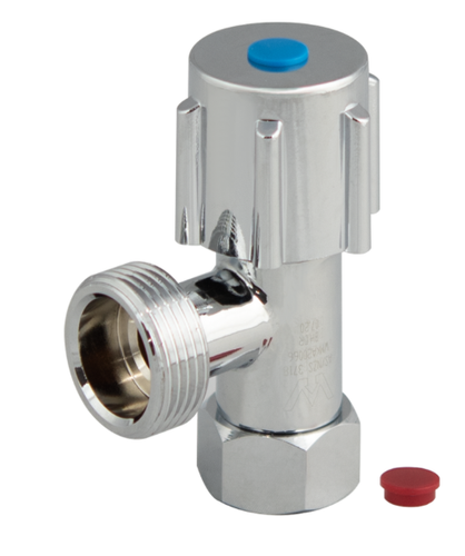

It's definitely not a washing machine hose issue since the water pressure from the tap is low. If pressure from all other taps around the home are fine then there is an issue just with that outlet/pipe. Typically there aren't any filters on older style washing machine taps if you have them so definitely try @JacobZ  suggestions to alleviate any possible air-lock.

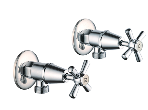

Failing this, there could be an issue with the tap washer on older style taps. Sometimes as they deteriorate the rubber can start to shred and cause partial blockages. Short stubby taps don't have a serviceable washer, but the larger traditional looking taps do. If you haver the older style and that look in tact and trying to resolve any air-lock doesn't work, then I would contact a plumber to have the line flushed.

modern shortmodern shorttraditional with washertraditional with washer
