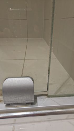

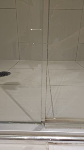

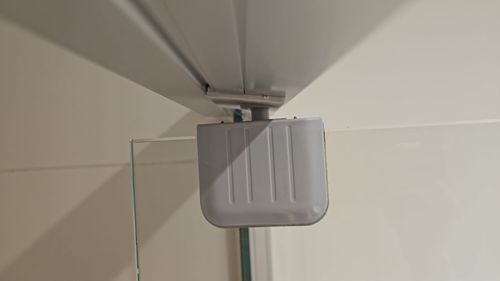

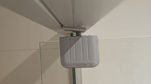

The glass shower door looks is rubbing lately and making a terrible screeching sound. The pins it pivots on to open and close look OK. Any advice appreciated.
photo: bottom left hand side - showing a very large gap between door and fixed panel
photo: Top pivot pin:
Photo: bottom right hand side - showing glass door butting up against glass frame:

It appears that the hinge holding the glass has allowed the door slip ever so slightly at an angle. This is therefore causing the edge of the glass to catch on something and is causing the screeching sound you hear. I'm not familiar with the hinge set that is on your door and am not sure if it can be adjusted. I propose engaging the services of a shower installer and asking them for quote on how much it will cost to repair your shower door and put it back into alignment.
