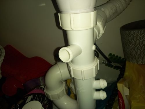

I have a brand new washing machine in a new house and the washing  machine waste water is connected  to to the sink hose . But when the water is draining  the sink makes a popping sound. Do I need too drill out one of the nipples  too stop this sound or will water come out of it once I drill it out. ?
I will post a photo.

Hey Eric the popping  sound is actually  in the drain. You can hear the water running then it starts popping  inside the  drain . That is why I was wondering  if it had one of the barbs open  it would let air out ?
The machine itcself is quiet.

If you believe that the popping noise is coming from the drain, I suggest trying a quick experiment the next time you use your washing machine. Remove the waste hose and let it drain on top of the the sink. If the popping noise disappears then there is a possibility that the waste pipe you've connected to is not sufficient enough for the washing machines wastewater and is creating a backflow problem.
Please trust me that drilling a hole in one of the barbs will not solve the issue as water will overflow in that direction creating more issues. Once you've determined that the source is the outlet pipe, I suggest engaging the services of a registered plumber to replace the flexi hose you currently have attached with a solid PVC pipe. This will provide unobstructed flow for the wastewater.
