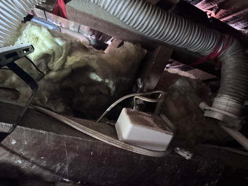

  • I took the cover off and I actually initially wondered if there was some kind of thin layer of foam insulation, but no it was a thick layer of dust. Hence the rather strange looking contraption I have attached for when I start getting stuck into the roof space vacuum.  It’s wonky and unconventional, but I’m injured, so I’m just doing what I can.

  • And the ducting is plastic? Is that normal?
