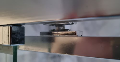

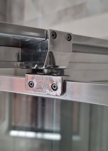

My shower door doesn't close, I've seen people show how to fix by adjusting the hindge to lift the door back up. Except mine is not your typical hindge and no obvious Phillips head screw that I can loosen to move. Appears like a specific tool or is that riveted?

Generally speaking, yes, shower door hinges will sometimes have screws in order for you to adjust its position. However, in your case the hinges are riveted to prevent movement. This leaves me to believe that something else is amiss. It's possible that your shower frame is leaning to one side and is no longer square. In the interest of health and safety, I suggest engaging the services of a shower installer and having them inspect the current state of your frame. They should be able to determine if the frame is loose or if something else is causing the door to go out of balance.

Thank you Eric. I can finally stop focusing on the door hinge. Will get someone to look into the alignment of the frame instead.
