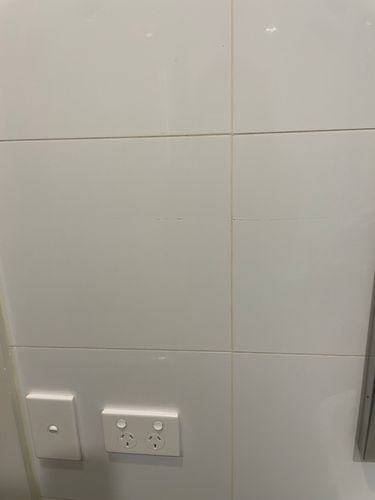

i am needing help on what to use and what to do with these scratched bathroom tiles.
my partner (bless his soul) tried to clean the bathroom walls but didn’t realise he needed to make sure the sponge head didn’t have a scouter and has scratched the tiles around the wall.
what can i use and do to repair them?

I propose having a look at using Selleys 50g Knead It Aqua Epoxy Putty. I suggest tearing off a small portion and mixing it very well in your hand so that it activates properly. Push the putty into the crack and use your thumb to feather it flat so that it is at the same level as the tile. Please note that it dries light grey and will not match the colour of the tile. But it will reduce the visibility of the crack and prevent it from growing bigger.
You do have the option of painting its surface, but colour matching may prove to be a challenge.
