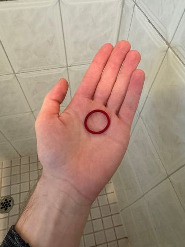

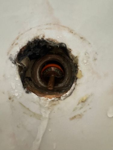

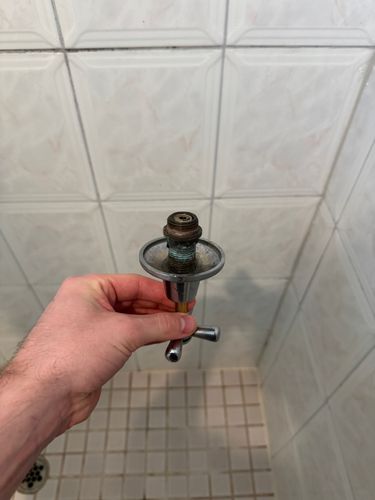

I have attached an image of the O ring, the tap from when it was out of the wall and the area it was attached to, as well as how the shower looks after I had put the tap back in. You may notice the cold tap sticks further out of the wall than the hot tap, that has been like that for a few months since the last time a plumber had worked on it. Hope these images are clear enough. Thank you for helping me out here, much appreciated!

It looks like the plumber has replaced the tap spindle with a longer one and it was not screwed into place sufficiently so over time, rotation of the tap and water pressure have caused it to work its way out.
I imagine you may have worked out where things sit, but if not please see the below clarification.
The washer sits where I have circled below.
It compresses against the breech where I have circled below when the spindle is screwed in place.
You will likely need to remove the tap handle and cover plate then use a Craftright 6 Piece Tap Spanner Set to tighten the spindle back into the breech.
