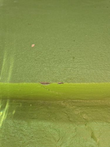

2. The builder has put two small tears (5-10mm) in the waterproofing in the edge of the step into the shower (photo below). It will be under the shower screen. The renovator is saying he will patch this, but from what I've read patching isn't really possible.

With the damage to the waterproofing, a waterproof membrane should be one homogenous surface with no nicks or tears, but it is also usually applied in multiple layers. As long as the repair that is applied is much wider than just a tiny patch job, then it should be ok.
