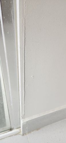

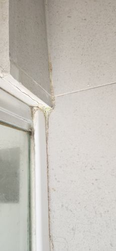

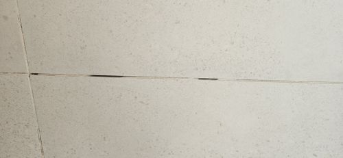

Hello, while trying to restore grout in the shower, I've noticed the grout has degraded and which seems to have caused water damage on the outside edge of the shower cubicle. What would be the best way to rectify this other or re- grouting would suffice?

Re-grouting the tiles is definitely something you should do asit will help prevent further water ingress. Here's a helpful guide: How to grout tiles.
For the longer crack on the wall, I’d suggest using silicone instead of grout. It looks like that area might have a bit of movement, and if you were to use standard grout there, it could crack again. A white wet-area silicone will give you the flexibility you need while still waterproofing the area, making it a more durable solution than cement-based fillers.
