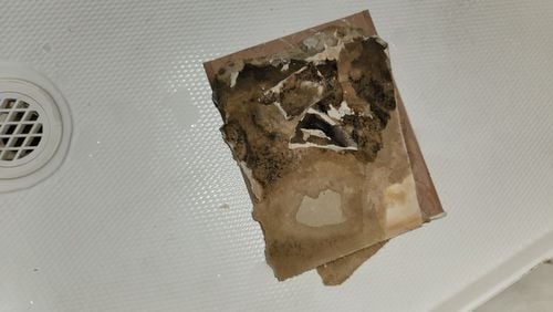

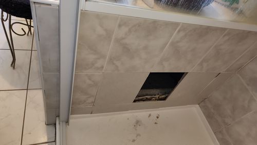

Desperately after advice on how I fix this. It's inside the shower. The plaster is wet(not soaking) behind the tiles so it's obviously been leaking for awhile. How do I fix this with little to no money. I know (I think) I need remove that whole wall but ???? I can figure out most things but this is a bit above my pay grade

Thank you DIYgnome. I'll get some more photos soon. The space is frame for the bath but no pipes. The taos and head are on the opposite side. I replaced cracked tiles when I bought the house as a temporary fix but never got to do the full renovation I wanted. Couldn't get the same tiles in afraid. 99% certain it has been leaking over the years from other cracked tiles. Kept putting it off due to the expense but alas, now see

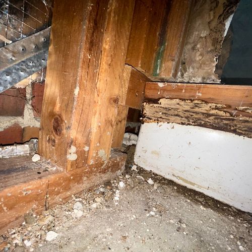

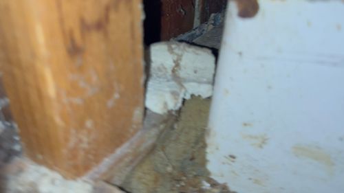

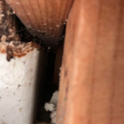

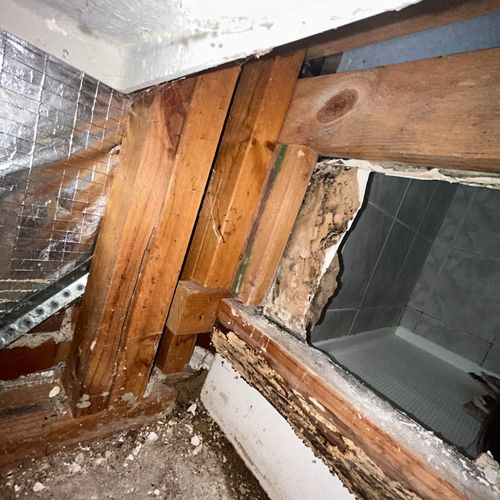

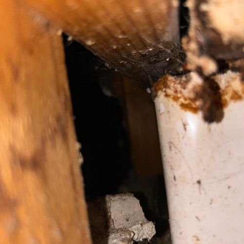

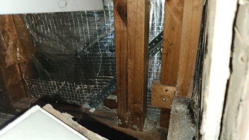

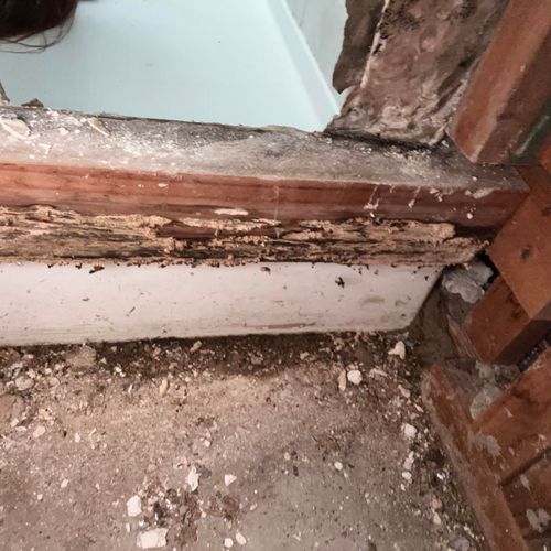

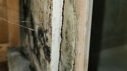

My apologies for taking so long. Not sure if these photos help but the way I see it the beams are still good. Obviously the plaster is knackered so I'm really hoping I can get away with just fixing that wall

Thank you for sharing those extra pictures of your wall. Somewhere along that wall the waterproofing membrane has failed. This has then allowed the water to pass through the grout and go directly to the plasterboard. You can clearly see from the tiles that someone tried to repair it awhile back but did not bother to waterproof the plasterboard.
Unfortunately, this is not an easy patch repair job. The tiles will need to be removed and a new wet area plasterboard will need to be put in. You then need to engage the services of a certified waterproofing agent to seal the wall and sign off on it. Once the waterproofing cures, you can then tile over it. Those will be the general steps needed to fix your wall.
I suggest posting the repair job on Airtasker or Hipages and make sure to include photos. It's important to put in as much information as you can and what you want done to repair it. This will at least give you a general idea of how much the repair job will cost you.
