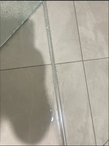

1. When I finished the shower, I saw a lot of water coming out of the frame and stagnant indicated on the green below.
Upon close inspection I saw that door is not completely shut on vertical part of the frame door ( he is coming tomorrow to inspect, hopefully fixable). The vertical movable part of the showerhas rubber along the vertical end. And, on the floor, there is a metal part (indicated in Red), which I think is not blocking the water.

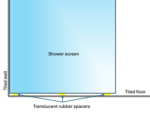

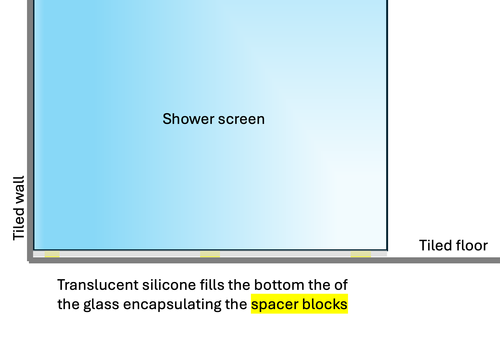

Sorry I should have used the term spacers @Sugar
Depending on glass length, two or more small rubber mounts/spacers about the thickness of the glass and a few mm high which sit under it. The weight of the glass hold them in position. then the cap is filled with the translucent silicone which is what secures the glass to the floor. Some shower screen sit inside a channel which is fixed to the tiled floor. But yours appears to be glass to tile which is the cleaner method.
These images should help.

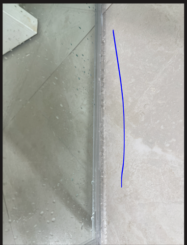

Following is my moving glass panel at the moment
Are you saying to apply more silicon on top of this metal bar ?
Re: Water leaking from newly renovated Frameless shower door
Hi @Sugar,
If water migrates under the bar, it likely needs some silicone sealant on the inside edge to stop this; it's an easy fix. Sometimes, water runs down the door and manages to escape under it and the bar below. If this is the case, adding a shower seal to the door's lower edge helps the water drip off it and into the shower enclosure.

He came and put some silicon rubber ( I think he bought from Bunnings) and put on the vertical edge of another panel (where the door would shut) and the bottom edge of the moving door. It has stopped a lot of water going out. I am happier than before. I am going to see for another few days.
Looks like the silicon was forgotten to put or forgotton to be supplied by supplier. It has worked now.
