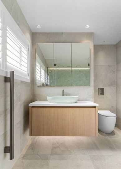

I'm in the middle of planning a bathroom reno. I want to install wall hung vanities in the powder room and ensuite. I think it would look great to have LED strip lighting underneath them, similar to this:
As I have a lot of smart home stuff, I plan to set them up so they turn on when someone opens the door.
I've done lots of googling but can't find information on where exactly they are positioned- do they just run along the underneath of the front edge of the vanity unit, or should I run them along the sides as well?

In regards to positioning, I suggest doing a bit of light position testing so that you can get the best optimal illumination in the room. I would recommend speaking to your sparky about the best place to have the power point. I propose having it installed inside the cabinet so that it is not exposed to moisture or accidental splashing from water when cleaning the floor. Adding a diffuser is like an extra layer of protection for the LED light from exposure, I would recommend putting one on.
