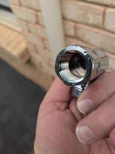

I attempted to install the mondella laundry taps but they leak. upon inspection, it looks like they are too deep internally. When they screw onto the pipe from the wall, they want to keep turning and I run out of pipe before they hit the tiles. from my measurements, I need 40mm coming out of the wall to make it sit tightly but my pipes past the tiles are about 25mm. the old ones were in place since new (16years)
any ideas?
