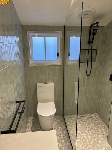

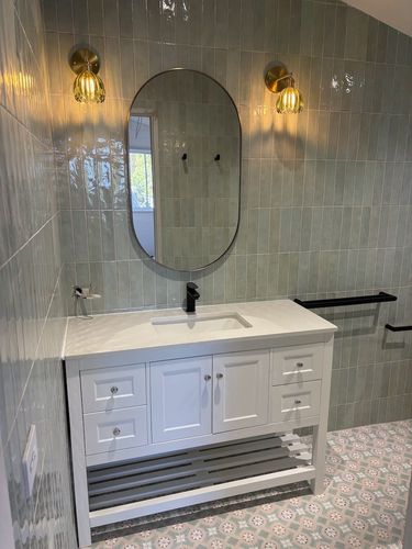

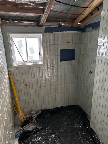

If it helps, please see below photos from a bathroom reno I did last year, which was all Aquachek.

Nice job on the bathroom Reno's, lots of straight lines to deal with.

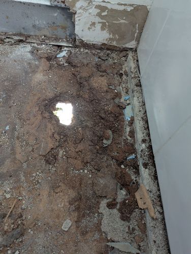

The shower base is a composite material solid surface that is Sikaflexed to the floor, Wet Area Solutions make them. I've attached a photo of part of the rot and the tile area I'm now ripping up.
