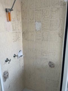

Yes, i want to install the wet wall panels over the existing tiles. I have already stripped the paint off, and the tiles have been sanded by the previous handyman before they were painted with renovation paint. Do I still use the product you suggested to clean them? I have already asked the special orders desk about installation and they dont have any installers so have to find my own.pic on its side (what both walls look like now)

Even though the tiles have been sanded by the previous handyman, I still suggest sanding it once more as the channels that were created is now full of paint. Sanding it over will clear some of the channels and create new ones for the adhesive to anchor onto.
