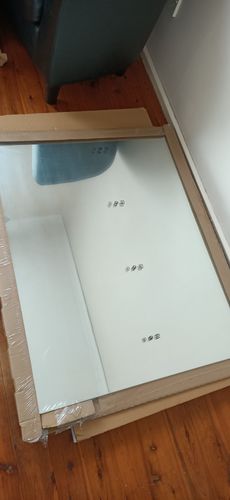

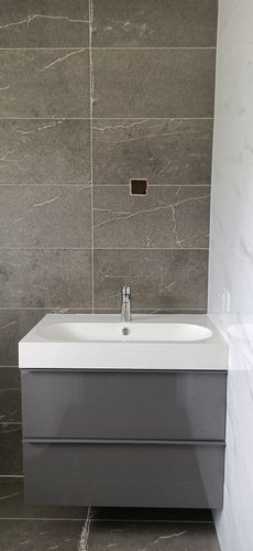

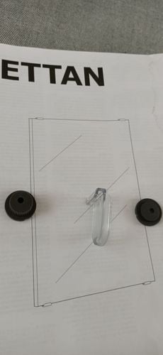

I am hoping that someone would be able to help me install a mirror on my bathroom wall tiles with noggins inside the wall. The mirror is 80cm x 92 cm (WxH) with some plastic brackets. I just do not know what screws, anchors, and drill bit to buy. If someone could help me, it would be much appreciated. I have attached photos of the wall, mirror, and brackets.

Are you fixing the brackets into the tiles or are you screwing them into the timber studs/noggins?
If you are attempting to fix them into the tiles I would suggest a kit like STAHL Masonry Kit 8mm Drill With 50mm Blue Wall Plugs but purchase a Sutton Tools 8.0mm Glass And Tile Drill Bit. If you are fixing to the timber frame or noggins (which I would prefer you do) then you could use something similar to Zenith 10G x 60mm Zinc Plated Hinge-Long Thread Timber Screws - 50 Pack.
I'd suggest you take the black mount into a store to assist a helpful team member in selecting the correct products for you. You might like to also enquire about options for just sticking the mirror on as is commonly done.

I am planning to fix it to the noggins inside the wall. I believe I have to pre-drill a hole in the wall before I can use a timber screw? If yes, what type of drill bit? Should it be of similar size to the screw diameter?

You'll be using a tile drill bit which is slightly larger than the shank of the screw. You'll want to run this drill bit at a relatively slow speed and have someone mist the tile with water whilst you drill through it. This keeps the bit cool and helps prevents it from becoming dull.
