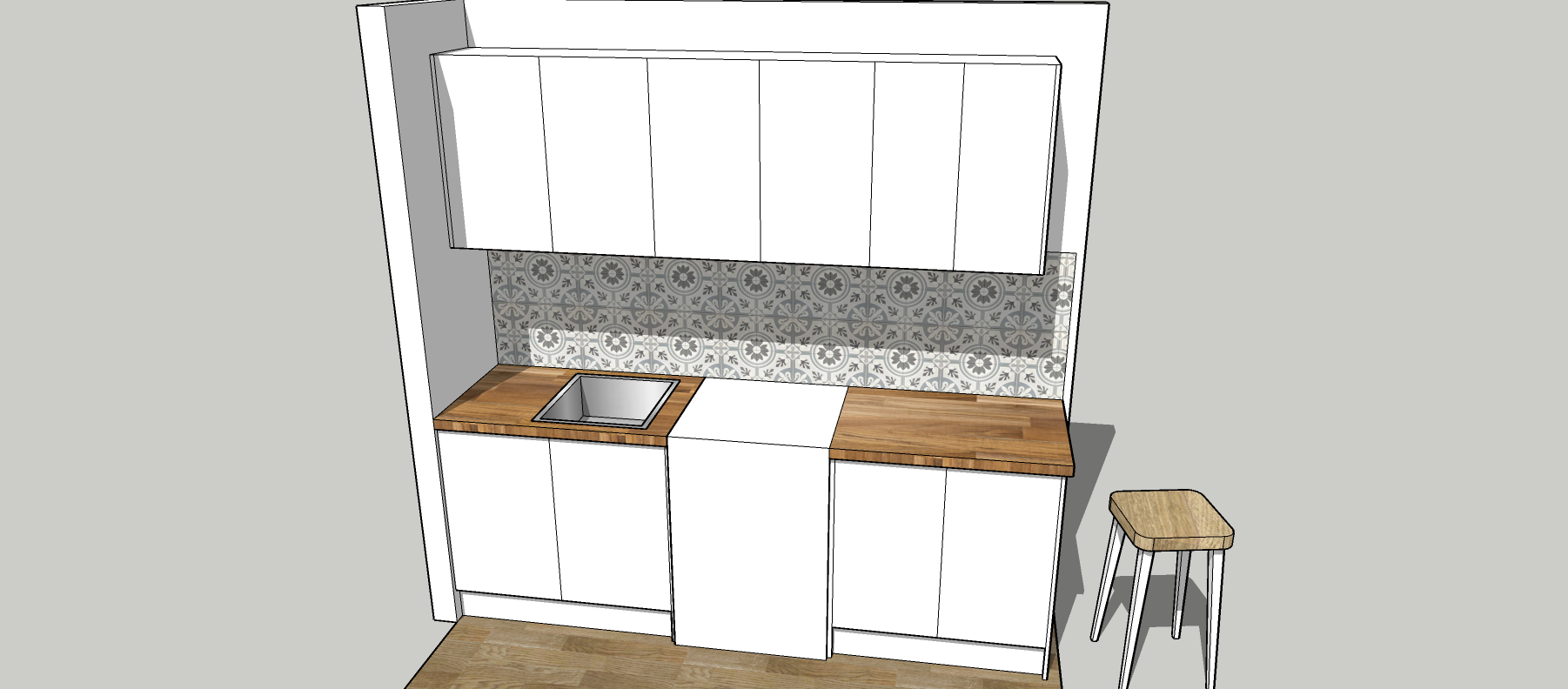

The cabinet could be 1.100 and would fit in under taps with drainage underneath. The tub would sit under tap .400 from the wall. The washing machine to the right under existing fittings.
So tub would be under taps with bench top either side.
Re: install laundry cupboard with tub
Hello @couttsonthemove
The closest cabinet to the size you are after is 900mm, it will still work as the laundry tub can be moved all the way to the right where the existing tapware is. The top loading washing machine would be better located in the center so that the pipework is close by.
The cabinets are:
  • 900 base cabinet
  • 800 base cabinet
  • 800 wall cabinet (X2)
  • 600 wall cabinet.
