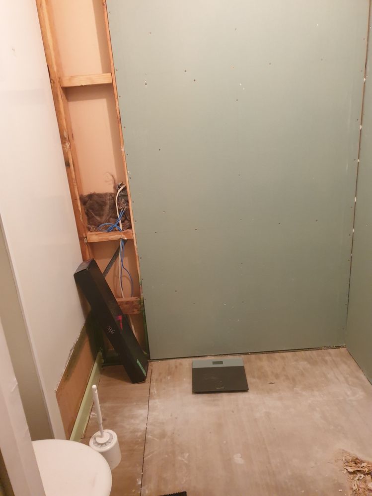

I've watched several DIY shower unit installs.  I'm getting a plumber to do most of the work since it's the first time working with such units, and there was existing bath/shower combo pipe work to be removed or rerouted.

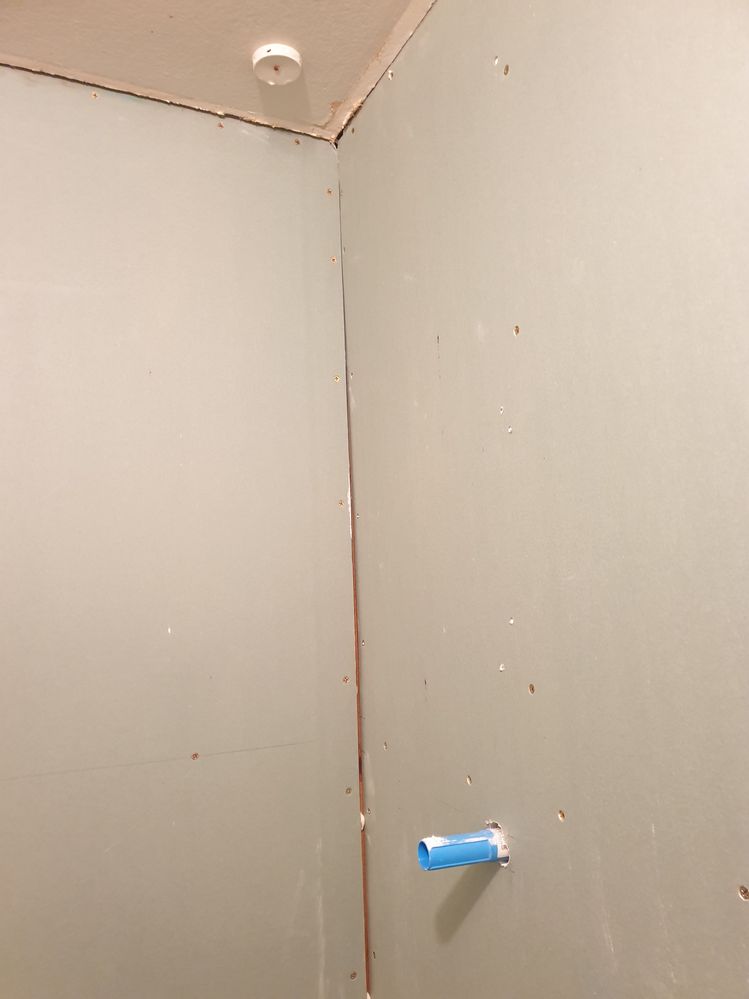

But I've got the drywall sheets up (aqua"gib"-like product). And despite many many measurements and careful sanding, it turns out the old timber frame is concave-bowed in the middle. Stud is 2400 (ie 2410mm ceiling). top and bottom line up, but there's a 5mm gap in the corner.  My level is about 750mm long, and in every plane and along every stud and dwang/nog, it tested as true and flat before I put the drywall on.  Vertical, horizontal, diagonal. Only a few peeks of light at the joint gaps.  But put the drywall sheet on - lo and behold, 5mm bow in the center of the mixer/shower head sheet.  I've haven't got a third sheet into the tiny room to check the second wall.
Is it savalageable?  What can I do?  it's a two sided liner with moulding to go in.  I REALLY don't have cash to pay a builder or anyone else (a $10,000+ bill elsewhere to pay).
 How can I not get such bow in the future - I checked this _dozens_ of times, paranoid level of checking.
And what is the fix?  It's a multistory house, with handiplank wall, and I'm not going to replace the whole stud (@ good chunk of wall).

Welcome to the Bunnings Workshop community @mist42nz. It's brilliant to have you join us, and many thanks for your question about installing drywall.
It sounds like the best solution here would be to remove the sheeting and address the bowed stud. If it's only out by several millimetres, you might be able to pull it back into place and install additional noggins/bracing to fix it in place. Alternatively, I'd suggest taking a planer and fashioning yourself a packer that fills the concave-bowed section. The easiest option might be to adhere a square section of timber to the stud and then plane it down.
It sounds like a 2400mm straight edge to check the rest of the walls would be a good investment.
If you could post some images showing the issue, our helpful members might have other suggestions for you. Shout out if you need a hand uploading pictures.

I agree.  but it's also how best to do it.  If it was convex and bowed into the room I could sand it back.  but top and bottom line up, but how to pack the 5mm in the middle and out to 0mm at the ends, solidly enough for a shower room.  Also not tile, liner for cabinet style shower.  But the other limitation of course, is bathroom so the area is tiny, and it's a refurb, not a new install so I can't muck around too much without damage older wall/weathertightness etc
Re: Shower liner to go on bowed drywall
it's concave, and I'm fitting a tray and fibreglass liner, not tile.  (modular). I'm a trustee so technically it's my place and I get the say on what happens and have to foot all the bills, but I'll never be there or use it.  That means also a degree of idiot proofing (another reason for not tile).
I could slap on more layers, but it's already small room (having to overlap and block out 100mm of a window already).
being concave it bows away from the room. if it bowed into the room I could just sand it back.But on my level it showed as straight and flat (over the 750mm). I had tried a weight on a string line, but with the breeze and few other factors it didn't really have accuracy in the middle of the wall for this job.
Bunnings New Zealand don't sell a 2.4m Straight Edge, and I had used a bit of kiwi 4x2 to check it , but NZ timber is crap so it was more bowed, warped, and cupped than the wall.
But real puzzle is once I get that sheet ripped out, when I use my new 2.4m concrete screed ($160) to give me a straight line, how do I get a straight line that is secure enough to do the job. it's 0mm at the ends and 5mm in the middle and has to last.  And as mentioned this is a multi-level and refurbish job, so I can't cut and wedge it without risking damage to garage roof (which is on the other side of the mixer), and all the rest of the timber in the wall (it's over 30% solid wood already, with the various bracing, packing, screw fixing points, and roof backing/packing for where the garage roof attaches about 1m of the floor - so running a second board upside the stud is totally out.  but if I use a 0-5mm shim is it going to be strong enough backing for the aquaboard and shower liner, since people are going to be constantly leaning or pushing on it.

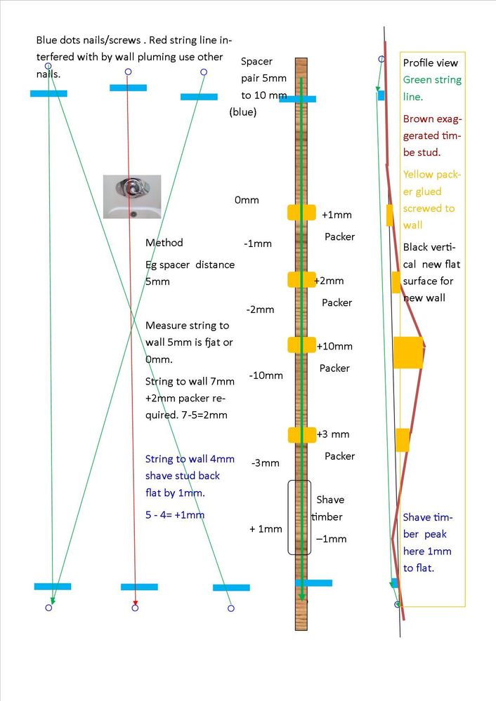

But  Dry wall removal option:
in a nutshell .  I would use your straight edge and  find any stud high points first then  measure and find any low points across timber and add packers untill your straight edge or string line(if  plumbing in the way)  says  flat.
Wall levelling  (see  drawing might show you quicker.)
You  where asking  how to do this even if you know other readers might benefit.
I would put 4 or more small nails or screws 4 top  4 bottom of the wall and start  a vertical  string line on the edge  moving  across 4 approximate vertical lines across the middle. or  across each and every stud in wall.  Tip:  tie a open non closing loop in end of the builders string ideally so it is easy to move  from screw to next screw testing the wall.  Easy  way is to loop screw 1 at top , wrap string around screw2 bottom and wrap 2nd time  another screw to hold suitable tension  Push the string flush to  wall with you straight top bottom rails and dont let string be obstructed by any thing in its path like the outlets. if outlets  hinder straightness move nail or move string at diagonal.  See diagram red (bad) and green  ok Now tuck  any spacer of the same thinkness  at the top and bottom of the string. this will hold it off the wall incase it bows out touching the string.
Now measure from the string line to the wall or wall stud timber.  EG  5mm spacers ( this means subtract 5 mm  off your measurement  of 5mm and that is a flat wall spot no spacer required. 5mm- 5mm is  zero)  ok  wall is flat at that spot .  If you measure  8mm that means the wall or stud is moving away (bowed inwards from straight  by 3mm  (8- 5mm space is +3mm  that  means add 3 mm spacer here (Tip write this +3 on the wall as you go. ) The more  timber in the wall the more places to  fix more shim glued and screwed the more packer points the firmer the wall this dosnt matter if wall has only studs or a pre existing wall. (Preexisting wall find studs to do string line and attach packers too) If you have a 5 mm spacer and you measure 3mm that means the wall is bowing outwards 5- 3= 2mm and you can shave the  extra 2mm off to return  the wall to flat. 0mm . When you lay your new sheet it should be very close to flat.
Look at the diagram showing string lines and a  pretend timber stud profile going from a radical +1 to -10mm  fluctuations  add  packers and shave wall back to 0mm .  This  can  be applied to your wall  whether you remove your first sheet of dry wall or  add another sheet of villaboard on top.Surface straighteningSurface straightening
A straight edge is great  for many things you  can measure  the gap under the edge to the  timber for  the shims (hard to do one person) but if you  get a bow it causes you to take straight edge off your two top and bottom rails.  You will know its a bow so I guess you can  plane that  a bit and try again.
Well if you wish strip that dry sheet out not to costly i hope for you.
I hear you as to all that timber behind the wall a night mare of ups and downs I am very sure your seeing.  But the benifit is   the more timber the more avaliable  fixing point for packers.
Lets  call your  vertical wall 0mm from top to bottom. Shave the high spots to 0 mm pack the low spots  outwards   to match  0mm on every stud making sure noggings and extra wall timber  are not protruding past 0mm.
Good luck with your  options  I so  hope my info isnt to taxing to read and  understand

  At least the Straight Edge/screed I will spot inwards bows much more easily, since it will rock on the high points.  I can also draw a pencil against it, which I can't do with a string line.
Thanks for taking time to draw out the picture it did help.  My mind was set on using a full fillet packer, like would be used in fine furniture - which is why a steady 5mm to 0mm is a fiddle to get right. My table saw died on the last job (brushes?).  But you're right, I can do it with shorter pieces (eg 300mm long)  tailored to the specific fixing point, since the dry sheet goes over it, and the liner will spread the human load a bit so the edge of the dry sheet won't be at risk to impact loads (note in last job I tripped over water bottle and dented the joined piece I'd backbraced, so bit sus on poorly supported drywall now...)
