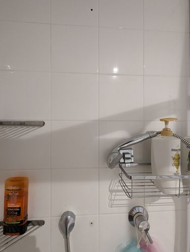

This is my current shower head set up.
I'm thinking of installing the new showerhead below. But just figured out that this is based on the water source (arrowhead) on the top. Is there a way to redirect my current set up so I can install the new one below?
Is this even possible? Or I have to find another showerhead that is similar to my current one?
Thanks

Thanks!! Sounds like I have to change to the similar style water inlet from the bottom as per your suggestion...
I thought there might be a diverter I can put instead.
Otherwise A plumber cost and potentially breaking into the tiling too.
Thanks
