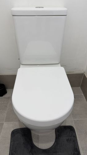

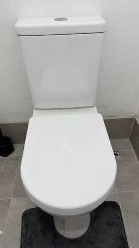

How to install toilet bidet?
jack89
Getting Established
how to install spray toilet bidet seat DIY?

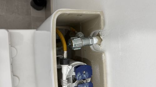

Water T junction is inside the the water tank and toilet is wall mount..
plz advise.
thank you

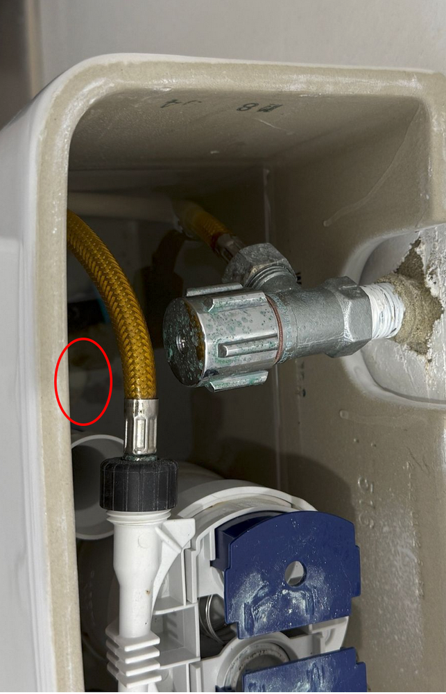

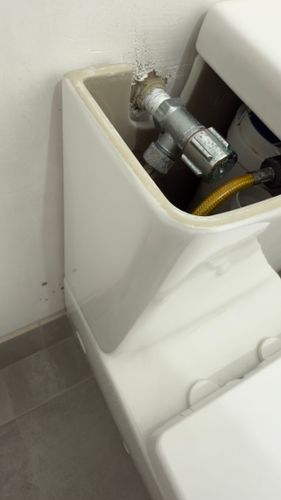

but my main concern is if I use “ Brasshards 15 x 20mm Chrome Loose Nut 2 Way Under Sink Tap”
I have to make drill in water tank OR in lead to for hose that goes to conn et bidet seat bcoz main water tap connection is inside the tank.
so how to solve that.??
thank you
Re: toilet bidet installation
Hi @jack89,

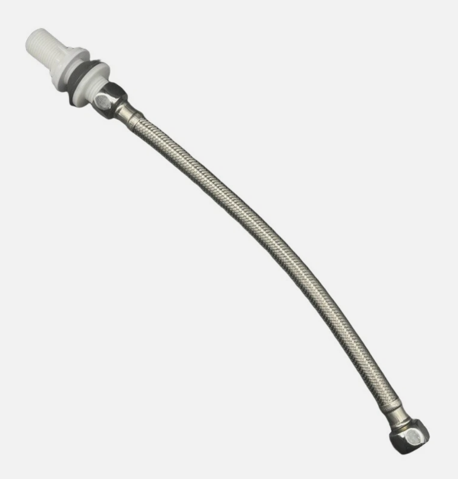

Unfortunately, it's either drill through the cistern or have another supply point installed on the outside of the cistern, which would require a plumber.
You can drill a hole above the water line in the cistern, using a Holesaw Arbor and a Diamond Grit Holesaw of a suitable diameter to allow the flexible hose to pass through.
You can see an example of this being done in @bazzyboy's discussion on the Best drill bit for vitreous china (WC)?

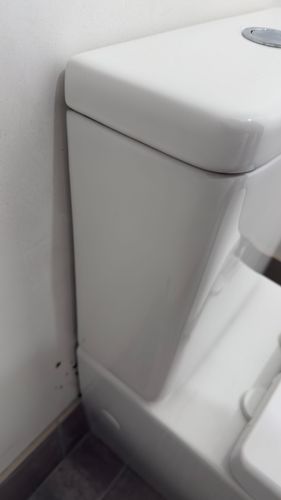

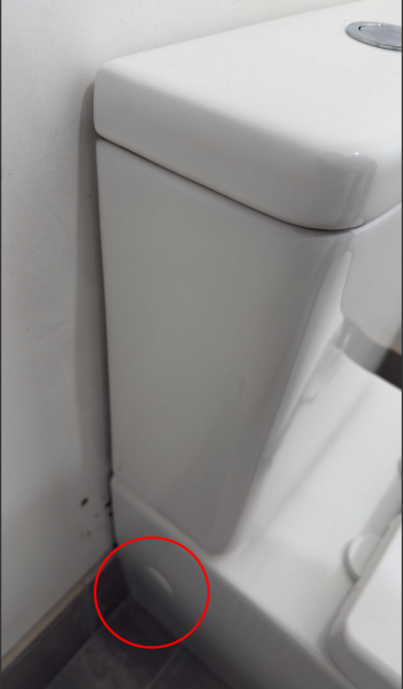

I have a very similar toilet and was wondering the same thing.
On closer inspection the bowl of your toilet has plastic plug on the side and if you look in your cistern, at the bottom you should see a plastic plug with a rubber gasket which is where you could run hose from inside your cistern out though the side of the bowl.
The hole in the side of the bowl might not be big enough for the cistern connector so it may involve some work removing the cistern unfortunately, however, better than drilling a hole in the side of it.
