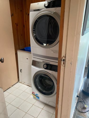

Recently bought cabinet to put under the washer and dryer for some height and extra storage.
however I have no idea how to get it under the stacked washer and dryer that seems to heavy to lift. It’s in a confined space
any help or suggestions pls

The only safest and possible way to achieve this is to down stack both appliances with a two person lift.
From there place the assembled cabinet down on the floor and stack both the appliances back on top.

Yes have though of this, but just with it being heavy and also doing this for my elderly parents, no much man power.

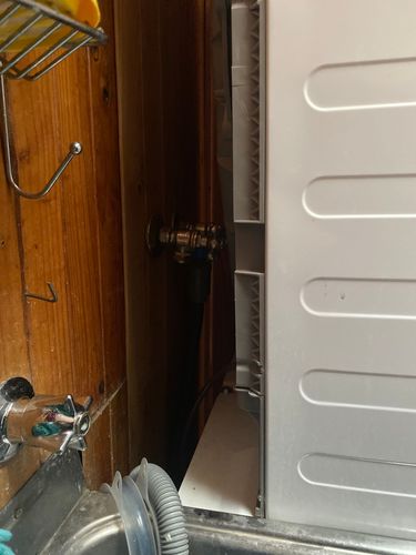

Additionally I am also unsure if there is anything I need to disconnect prior to doing this?
No worries 😊
The washer will need the hot water and cold water hoses disconnected from behind the appliance.
Both will also require the power plug unplugged. Safest to switch the power of at the mains when doing this.
It will also help to disconnect these once they are partly away from the wall.

It's fantastic that you've received comprehensive advice from @TheRenoDad. Just to add to the suggestions made, is there any chance you can perhaps enlist the aid of a neighbour to lift the machines? Do you have any mates that are willing to lift this for you in exchange for some light refreshments? Failing that, I can only suggest posting the job on Airtasker or a similar service.
However, before you proceed, I suggest having a good look at the weight rating on the cabinet if it is capable of holding both the washer and dryer. If it is then there is nothing to worry about, but if it only says washer only, placing both machines on the cabinet will void its warranty.
