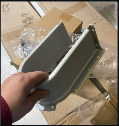

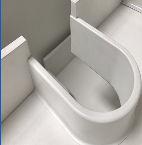

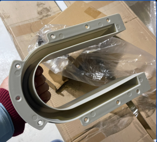

We just bought 1800mm vanity and the vanity came without precut U-shaped loop. The vanity came with U shaped Contour though. Supplier said the product does not come with precut because they let customer to cut according to their need. I need to have the U-Shaped at the centre of the top two drawers.
***** Want to have like this ****
*** What's been provided to me, when I bought the product*****
