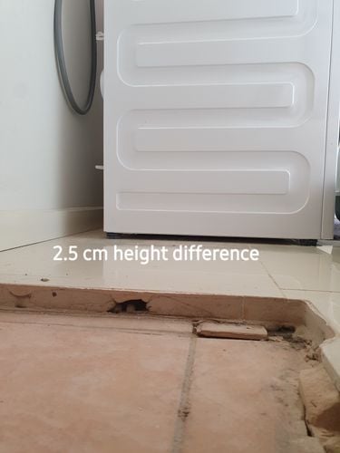

Hi All. New to workshop but really enjoying the posts and different ideas.
About to do a laundry reno. Old 70s house was partly renovated when I bought it, of course except for the wet areas.
Laundry was very simple. Tub and washing machine. Space I have to play with is around 2.4m long. Plumber has been in to start moving pipes to become "hidden". I've removed the tiling and tub. When the plumber is ready to return I will cut away a lot of the plaster for him to do what he needs. (As you can see the plaster is past its use by date anyway)
So have now noticed that the floors have previously been raised, I'm guessing so tiles can be laid throughout the house, hence leaving me with  2.5cm difference in floor height where the tub was. So question, Is this just a case of screeding to bring it up the same height as the rest of the floor?
Future plans are to install an 800mm kaboodle cabinet, washing machine, and 450mm flatpax linen chute. Cabinet doors will be simple in gloss white. I'll also replace the door on the chute to gloss white. Add an Abey 30L laundry trough and mixer tap. Love the look of the kaboodle 'smoked oak' benchtop. Will use wet area VJ panels instead of tiles to keep my budget down.

3) - The maths of square metres and cubic (or fill metres) can be very confusing. The real trick is to stay with the most convenient measurement unit - stick with either mm, cm or m.
So, as an example... if you had an area that was 2m (200cm) side-to-side (length) by 1m (100cm) back-to-front (width) and it needed 50mm (5cm) of filling (height/depth) the calculations would be 2 x 1 = 2 This is your area, 2sq/m, remember this is surface area.
For volume we need to get into the 3rd dimension and here's where the important thing is getting the decimal point in the right place.
Your 5cm is .05 when using whole metres in your calculations as we did above. So 2 x .05 = 0.1 of a cu/m
Does that help?

 HI All. Laundry is slowly getting there. Cabinets fit well. I actually had to exchange the 450mm cabinet for the 400mm, which will still accommodate the kaboodle laundry hamper( which currently seems to be unavailable anywhere in Victoria) Holes still need to be made in the back of the main cabinet to accommodate the taps and drain pipe. I haven't yet thrown screed in the uneven floor space and undecided whether I will or not. The cabinet is sitting in the space quite well so I may just glue some quad around the edges to block out any draughts.

If your cabinetry is positioned well at the moment, I wouldn't bother levelling the floor. Squirt a small amount of expanding foam in any of the gaps. That will seal them up fine. Once you've done that, put the kick panels on, and nobody will ever know.
