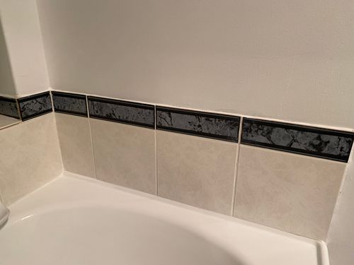

Oh no !!! I’ve just noticed there’s paint on the edges of the tiles.
Do I just carefully wipe down with a damp cloth ?
Do I silicone it after to make it neater ?
I’m not sure what to do….. it is just exposed tile edges

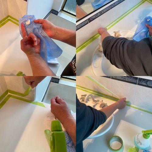

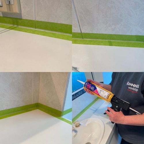

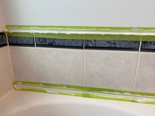

I suggest using your newly learned skill on how to apply silicone using a masking tape guide.
However, my best advice is to take your time when lining up the tape. I also propose not making the line very big so that it does not overpower the edge of the tile. Your goal is to cover the exposed edge and give it a nice finish.

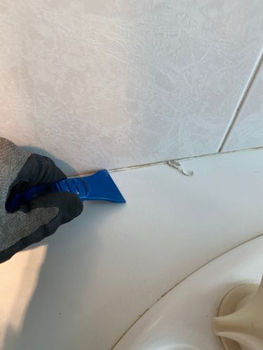

 Good morning Eric. I cleaned, scraped out old silicone, taped and reapplied !!!!! I did it around the bathtub, the top of the tiles and also the bathroom counter. I can’t believe how much I enjoyed it !!
