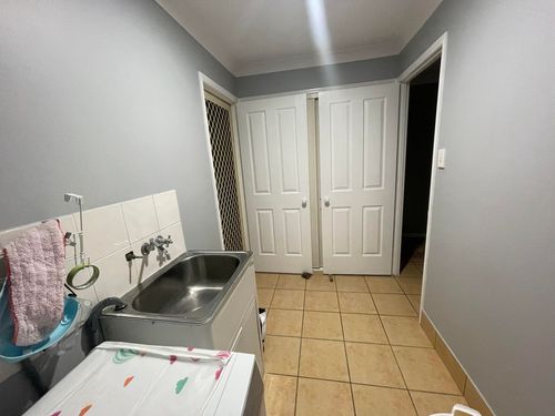

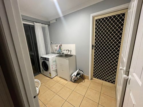

not sure if anything can be done here
Something what we want here

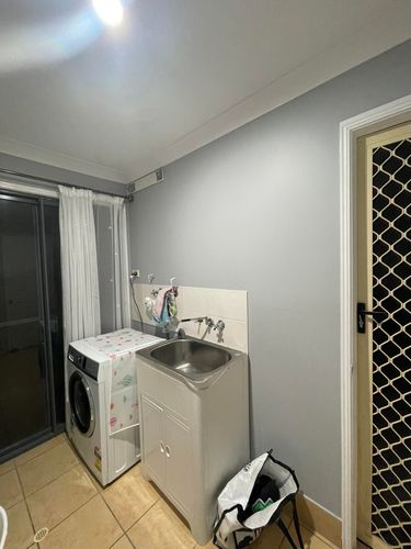

Above images are from my laundry room. We want to remove this old sink and taps.

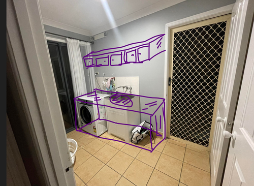

I am not sure if the water taps can be move from its existing place to towards the security screen. If this can be done, then what we want is to make space under the benchtop where dryer and washing machine can go side by side. if the taps cannot be moved from their exiting place, then the sink has to be at the centre of the bench top.

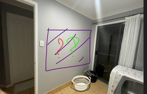

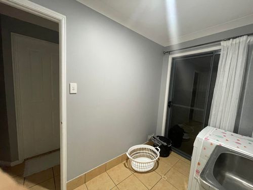

Also, opposite them is another wall. Attached is the image and we are not really sure if anything can be done here. any advice will be highly appreciated.
Thanks a lot Renovation-loving guys

Taps can be moved wherever you want, it's just a matter of employing a plumber to do so. I'd recommend moving the taps and sink next to the window. It's a better flow if the sink is in the corner.
I've created a rendering for you below based on a guesstimation of the floor size. If you can provide the dimensions of the space then I can double-check whether the design will work. The room is a bit too thin to have cabinetry on the opposite wall. However, you could look at doing some open shelves above head height.
Let me know what you think about the rendering and we can discuss the next steps.

And for opposite wall, we are still thinking what can be done here. You idea of cabinets above head heights is also a good option.

The cabinets used in the above rendering were a 450mm base cabinet, two 900mm slimline cabinets and a Hevea benchtop. Remember that was based on an approximation of size. If you take your exact sizes with you, then the Kitchen Expert in-store can assist with selecting appropriate cabinetry for the space.

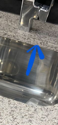

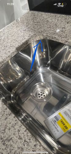

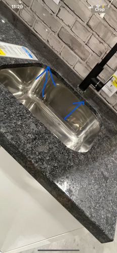

I visited Bunnings store yesterday and say how the sinks have been placed first and then benchtop on the top. Looks really nice. I have some pictures here.
I am getting someone to cut but I hope it is possible to do it in Laundry to and how do we do it?

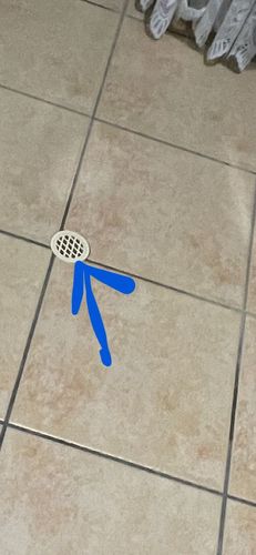

also, while flooring on the laundry, how do we manage this hole on the floor?

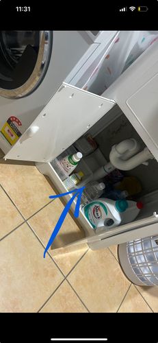

I had one guy coming this week and he suggested that we need to have the washing machine raised and have some gap underneath so that the discharge pipe from sink (when installed on far left) can be router to the existing drain hole which would be sitting underneath the washing machine one installed it at the middle.
good advice from him but making sure on this forum also that there will always be a way to raise not only washing machine but dryer as well ( otherwise they will look uneven if done only DW) ? However, I believe that the cabinet that holding sink will need to be bought taller, plus side panels? Do you see any issues here?

Those sinks are attached with adhesive after the bench is installed from underneath. You'll need to purchase a sink designed for under mounting, and it will include instructions on how to do so.
The drain grate must be raised slightly to be flush with the Hybrid flooring. It would be best to have a plumber do this for you.
It appears you do not intend to have the plumbing moved to the new sink position; instead, route the waste pipe to the existing floor piping. It sounds like the plumber has provided a solution for routing the pipework under the washing machine. As you've identified, raising both machines, the cabinet and panels for consistency would be best. This will require a custom plinth frame to be created for the machines to sit on, but that shouldn't be an issue for a handy person to achieve for you. I can't see any issue with this approach.
