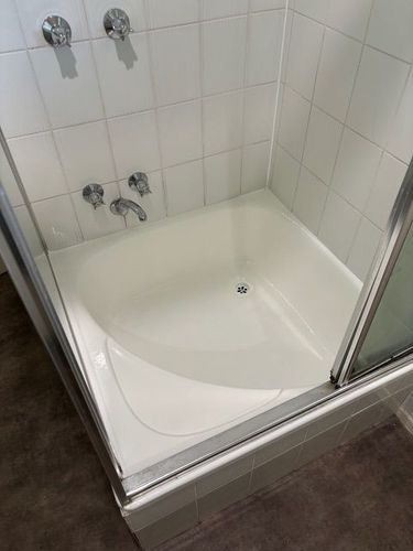

A tip when using the Rust-Oleum 946ml White Gloss Tub And Tile Refinishing Kit is to really follow the preperation instructions. And to apply each coating thinly as it will run very easily with its own weight if applied to thick. And you need plenty of ventilation as the fumes are very strong. The photo below was one I did a few weeks back. It was originally pink.
