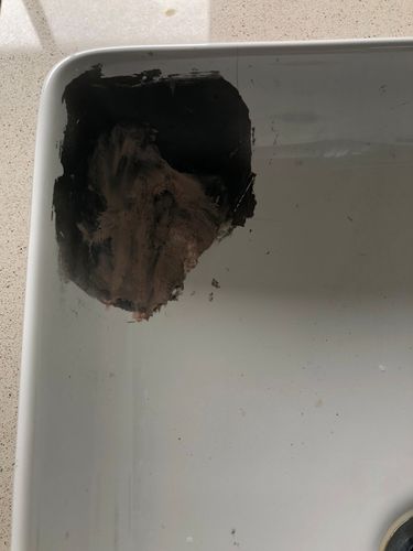

Hi All,
Looking for advice on the best paint for a bathroom basin.
Crack has been fixed/patched just requires a paint job to match.
TIA

Thank you for your reply Eric.
I believe it was filler/fibreglass that was used as it was a decent hole.
It has been sanded down.
Hoping this is helpful.

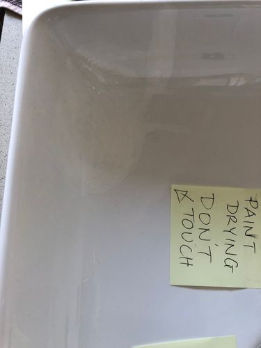

Hello @Rhiannon1
Thanks for that extra information about your repair patch. I suggest using Rust-Oleum Tub And Tile Refinishing Kit as it is rated for use on fibreglass. Please keep in mind that this is a coating that needs to go all over the surface and not just the repaired area. Please make sure to follow the instructions on the packaging.
thank you for your help very happy with the result just needs another coat ![]()
Hi @Rhiannon1
Thank you very much for posting that photo update. Your repair work looks fantastic, one more coat and it should blend in nicely.
Please keep us updated with your progress, we look forward to seeing your basin fully revamped.
