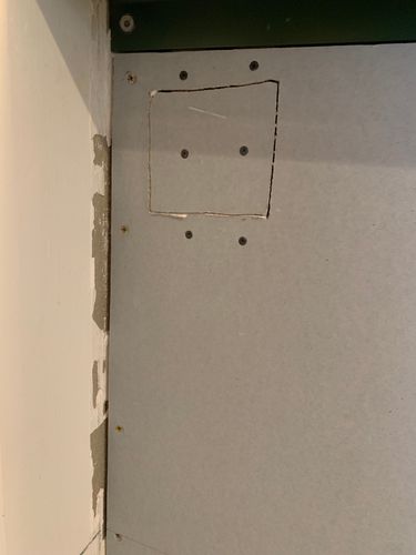

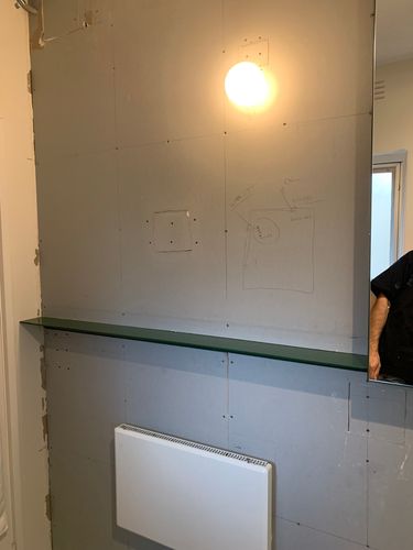

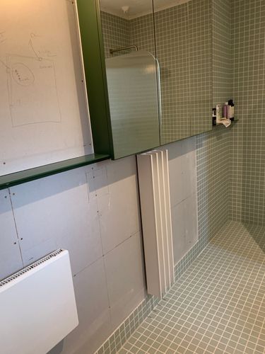

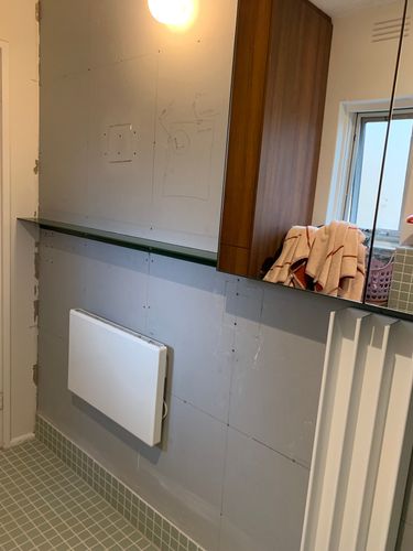

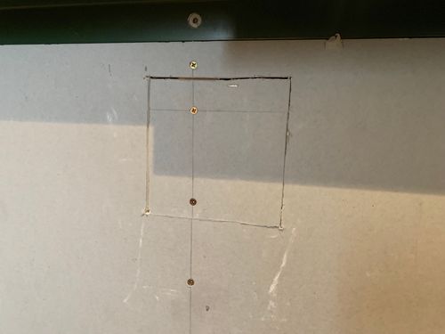

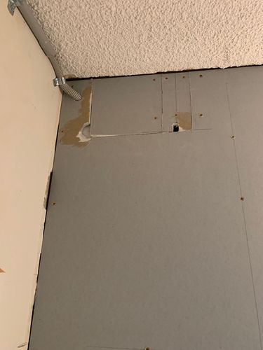

I'm after some advice on the best way to finish off my bathroom renovation. My plan is to patch and paint this Gyprock wall, but with the amount of cut outs (from electrical works) and various chips, scuffs and screws, I'm just wondering what the best way forward is.
Could I get away with simply using gap filler and then priming, sealing and painting?

For small to medium sized joins, I suggest using Gyprock CSR 2.25kg Less Mess Multi-Purpose Joint Compound in combination with Gyprock CSR 75m Plasterboard Perforated Paper Jointing Tape. My best advice would be to make sure that the joins are clean and free of debris. The general steps would be to apply the joint compound and place the tape over the joint and then applying more joint compound over the tape surface.

The correct steps is essentially as @EricL outlined.
