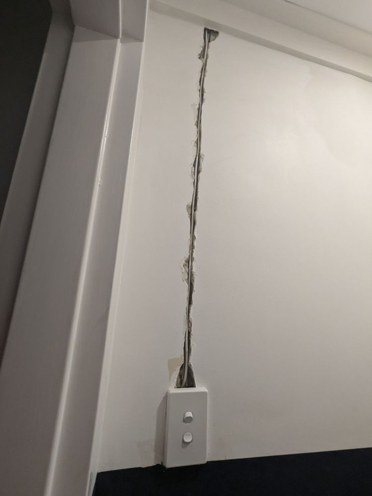

Sparky chased the brick wall. Just wondering how best to patch it up?

Woops sorry i thought i had included the photo. I have added it now. The cables have not been encased so i guess i can do myself?

Hi @jordanperret
@MitchellMc fast set morter will work well and it dose set fast so mix in smaller batches or work quickly use a steel float .
Technically that cable should be in a conduit or box more so if the cable is running externally on the wall surface, but a cable enclosed in a cement solid sheath covering is more protected they a electrical cable inside a gyprock wall. So do the maths on that situation @jordanperret for yourself.
Why didnt the Electrician use conduit in the first place one would ask maybe as it is an internal wire not external.
Right, so a potentially shoddy job?

I dont think your job is shoddy or dangerous any more than my place with exposed electrical wires inside gyprock once those wires covered up.

@MitchellMc @jordanperret @Jewelleryrescue
As per AS 3000
The ruling is a minimum 50mm depth from surface to cable without mechanical protection provided the circuit is protected by an RCD or RCBO
Else it needs to be mechanical protection eg in conduit.
Honestly if it were me I would put it in conduit either way because you as an owner or the next might hang a picture right where the cable runs.
And as always and I've said it a million times electrical is not a DIY job always engage a licensed electrical contractor to carry out the works, the first time may be your last.

As explained by @CSParnell, it needs to be redone by your electrician. Once your electrician digs the chase properly and has added the necessary conduit, that would be the only time I recommend covering it up.
