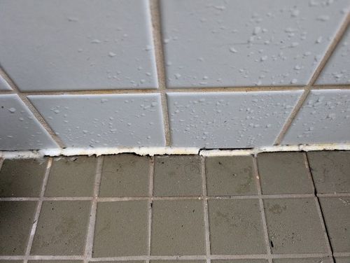

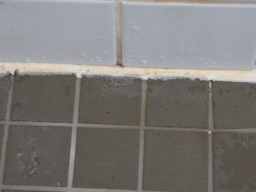

We have a shower with a wall/floor join that is obviously not in great shape. We also have very occasional little mushrooms sprouting at the join (actually none over the winter) which I know is bad and might mean rotten timber underneath and pulling up the whole floor at some point. In the short term I would like to properly seal the join.
This is the worst of it
This is the best
Should I redo the lot? What should I use? Should I do it myself?

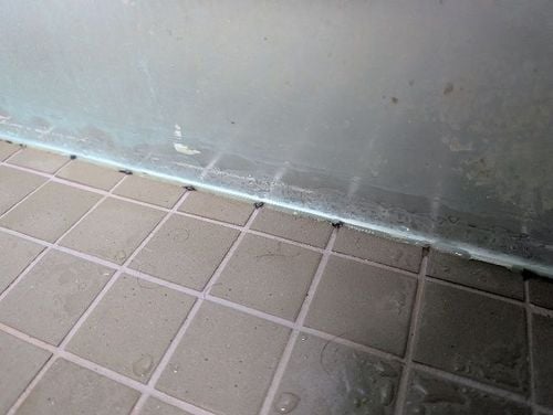

Also the glass partition detached from the floor after cleaning and is now only supported by wall attachments. I think it likely once had some clear silicon to keep water inside and stop it moving. What should I use/do here?

Thanks for sharing your question about the seals in your shower. If you are putting new silicone sealers, I suggest doing it all in one go so that everything is fresh and new. I propose looking at Selleys 300g White Wet Area Waterproof Silicone Sealant to seal your shower along with the glass panel.
Here are some handy step-by-step guides:
Please remember to wear personal protection such as gloves, goggles and a mask.

Can you suggest a transparent silicone for the glass panel? It might look better.

The Selleys wet area sealer is available in a transparent model - Selleys 300g Clear Wet Area Waterproof Silicone Sealant
