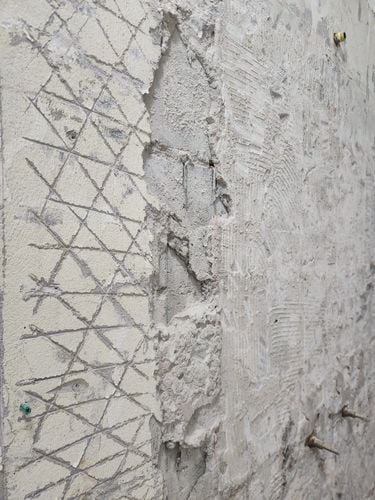

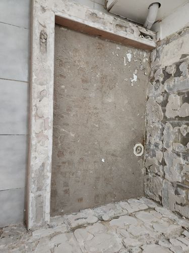

I am renovating my bathroom. I have removed all the old tiles and have reached the screed. It is in decent condition I think. My questions are:
- Can I re-waterproof over the exisiting screed? I really don't want to have to remove and re-screed as that seems like a lot of work.
- The walls are quite uneven, with chunks missing out of the render. What can I use to even them out to provide a nice surface for the waterproofing?

As long as the screed is solid and not flaking away, then you are fine to waterproof over it before putting down tiles. You can use a product such as the Crommelin Shower Waterproofing Membrane over the screed.
To repair the uneven walls, you can apply Dunlop Multipurpose Acrylic Render before waterproofing and tiling over it. Make sure you give the wall a good clean with a wire brush to remove any loose material, then wash it down with clean water to remove any dust that can affect adhesion. Check out How To Render for some guidance on the process.
It might look a bit messy, but you are not far off from waterproofing and then tiling.
