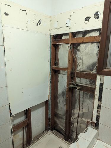

I recently had to demolish the shower walls in a my "new" 1970s house and it's 1990's bathroom as water had ingressed behind the grout.

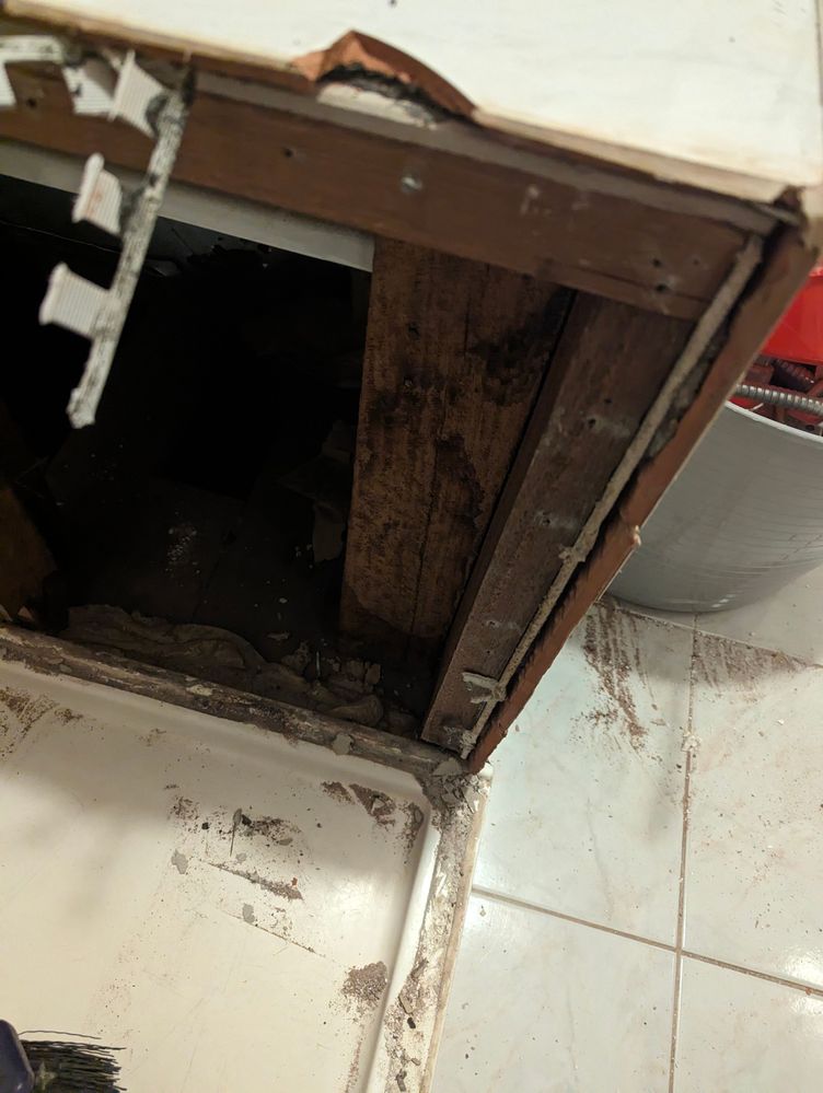

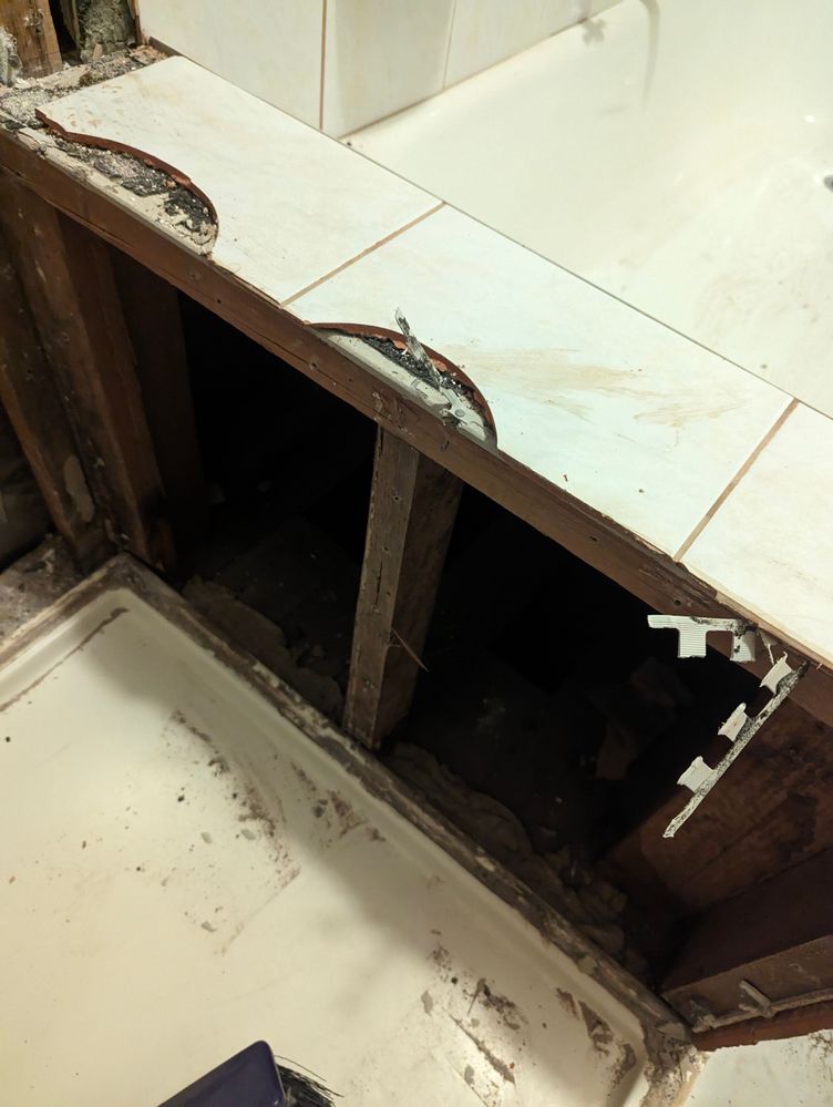

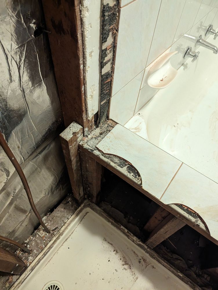

The original wall was composed of 5mm plasterboard, 6 mm fibro concrete and then tile. When. I demolished the wall I noted that the fibro was sitting on top of the flange of the shower pan, and the tiles were laid onto the fibro within the flange. In the photo you can see one wall still has some plaster up because it wasn't damaged like the rest was.

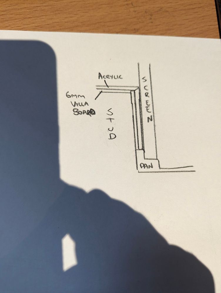

My understanding for the new wall is that the fibro should be laid within the flange as well as the interior wall, but I'm not sure.
For my new wall construction should I go with new plasterboard and fibro or should I just go with 9 mm fibro? Also, should I shim out the studs 5 mm so the new fibro sits in the pan rather than on the pan?
Finally my plan is to use acrylic sheeting for the interior walls stuck to the fibro. How would I tackle the bath enclosure where it shares a wall with the shower?
