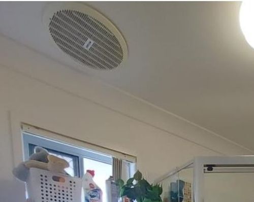

Is there an easy way to clean the exhaust fan? It's making a rattling noise.
What should we do? We have a can of WD-40.
Many thanks for any ideas..!
Most likely the motor reached end of life š. You should be able to pry open on the sides and get access to the fan to clean. You can also remove the entire set to clean it outside and put it back. The replacement ones are about 20-30$ and can be done by yourself because they are usually plugged into it and not connected to live wires.

It could beĀ a loose cover and some times a loose leaveĀ orĀ other etcĀ can fall into the blades and make thatĀ noise.
FanĀ power off
Stand on a stool the cover will come of lever it with butterĀ knife.
Dust the cover andĀ vacuum the fan bladesĀ use a bit of silicon spray onĀ the fan shaft if visable but not while power is connected.
Never use wd40 as it is combustable around power.
Test theĀ fan and see it it sounds good put the cover back on might beĀ good foe aĀ couple of moreĀ years.
Hello @ivanptrĀ
Please remember that if the exhaust fan is old the cover might be brittle so, please be careful when removing it. Make sure to wear disposable gloves as it will be very dusty and there might be leaves and loose insulation that has gotten caught up with the fan blades.
I suggest using Selleys 120 Pack Complete Clean Multipurpose Disinfectant Wipes. This will clean your fan blades and cover very well. However, if the noise remains then odds are the motor has failed and must be replaced.Ā
I suggest bringing your exhaust cover with you to the store and compare it with the ones available to make sure that it will fit in your existing ceiling cut out.
