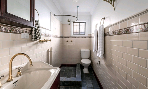

Hi
I want to paint the floor tiles of my bathroom, including the shower floor (in white) and am looking for the most suitable product for this.
I have seen the product below on your webpage (see link below), but I wonder if this is only suitable for walls (maybe too slippery for the floor?). Would be great to know what product would be most suitable for this job.
https://www.bunnings.com.au/rust-oleum-946ml-white-gloss-tub-and-tile-refinishing-kit_p0437239
Thanks for your help
