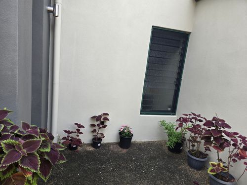

Hello @Moonysm72
Are you planning on extending the bathroom outside to that small extension where you have your plants? Do you wish to build something self-standing in that location without having to break down the walls of your home? If you can please tell us in more detail what you originally had in mind in regards to the look and arrangement of the extension perhaps we can offer more ideas.
Thanks Eric
Yes I am looking to build something self-standing in that location without having to break down the walls of my home.
I am hoping to have help in extending the bathroom and add laundry penchtop.
Mona
Hi @Moonysm72,
I'm sorry, as I presumed you wanted a more temporary solution. Regarding the relocation of the laundry, the first step will be to build an extension to accommodate it. I'd recommend you enlist the services of a builder to have plans drawn up for you to submit to the council. Given that you're creating an exterior addition to your home and it will include a shower, deeming it a wet area, the build will need to comply with construction codes. A builder is the best place to start with this.
