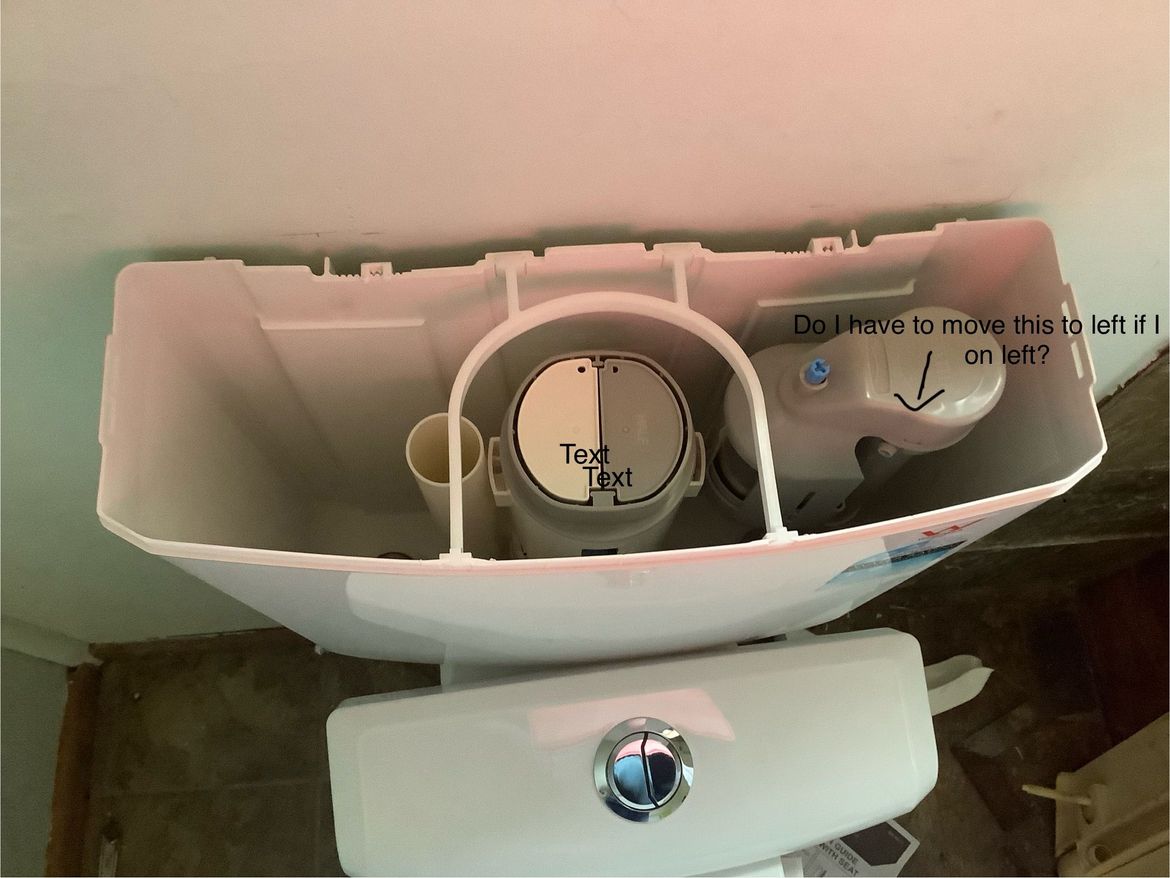

Hi Eric, thank you for your response. I am not trying to fix the inlet It is a new cistern . If facing it My water inlet Is on the left. However, above where this joins there is a plug. What I am wanting to know is do I need to Swap this over with the mechanism on the right ?
You should be able to change the position of the inlet valve to the left. There is a plastic nut and bolt covering the hole on the left, remove it and swap positions with the inlet valve. One other option is to extend the hose of the inlet valve with a Kinetic 150mm Stainless Steel Flexible Braided Hose Mixer Tap Extension so that you don't need to take anything apart.
