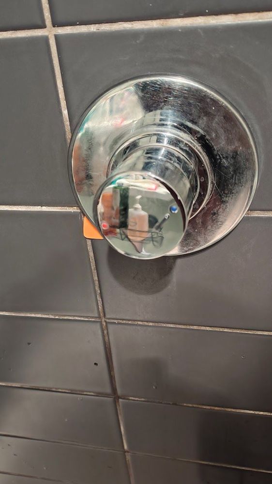

My shower mixer is leaking, and I suspect the cartridge might be the culprit—though I’ll know for sure once I get the handle off.
Unfortunately, I don’t know the brand (definitely not Caroma), so I’m working blind here.
What I’ve Done So Far:

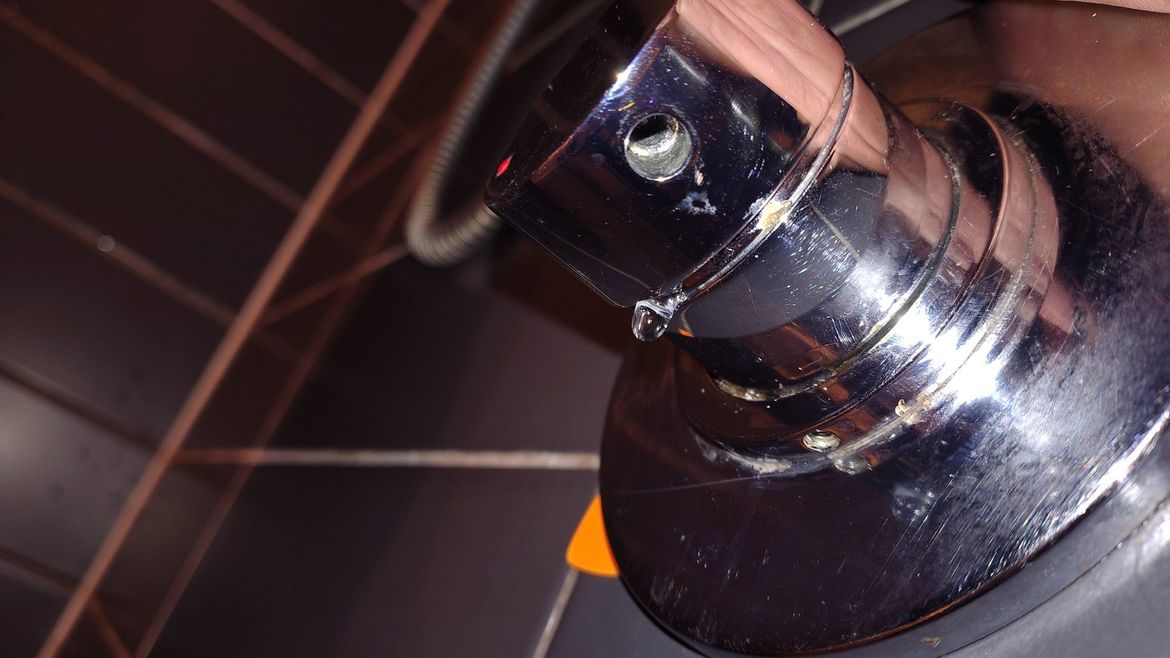

Unscrewed the retaining ring screw – not entirely sure why I did this, but it’s off.
Removed the pin lever – this exposed a protruding screw body, which I assume is a grub screw.
Loosened the grub screw using an Allen key.
Tried to remove the handle (the round piece with hot/cold indicators):
Rotated it clockwise and counterclockwise—no movement.
Tried pulling it straight off—still stuck.
Sprayed WD-40 and let it soak—no improvement.
At this point, I’m guessing the handle is seized or jammed. I’m considering using a rubber mallet and screwdriver to gently tap it loose or possibly sourcing a tap handle puller—but I’m unsure which method is safest or most effective.

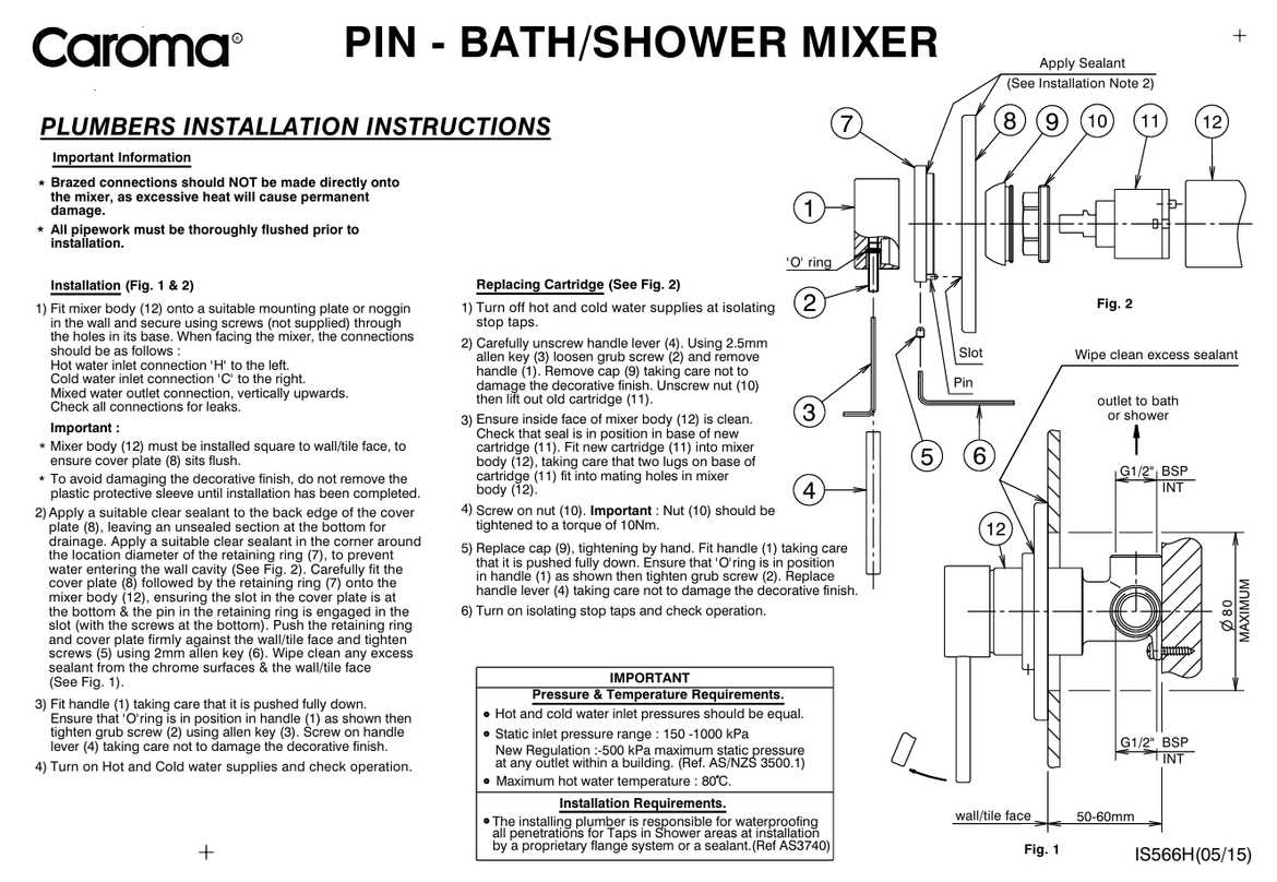

I’ve attached the installation instructions I found (see Replacing Cartridge – Fig. 2). I’m stuck at Step 2, which involves removing the handle.
Any advice on how to safely remove this handle without damaging the mixer? Would love tips from anyone who’s dealt with a similar setup.
