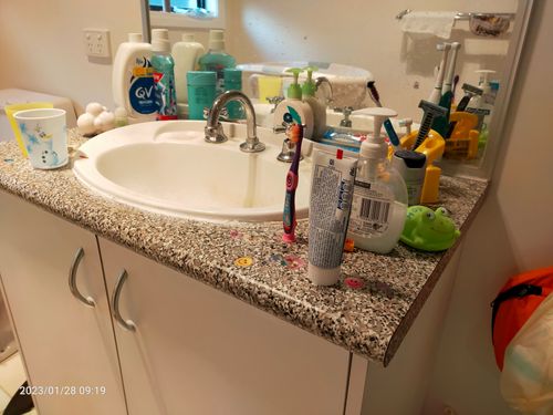

Hi All expert there,
    I'm changing my bathroom top from laminated to stone and changing the basin to caroma ( think ceramic). Question is
1. How do I remove the big mirror in my bathroom? Is it glue to the wall or nail?
2. The current existing top is 35mm and my stonetop is 40mm. Does that mean I need to adjust my mirror higher a bit?
3. The subtracted under the stone, do I need to glue it? If yes what glue should I use?
4. The new basin is ceramic top mount goes on top of the stone. Do I need to put sealant under the basin surrounding before I put the basin down? Or just put it down and apply sealant surrounding the edges? If no sealant under the basin will it chip the stone or the ceramic basin?

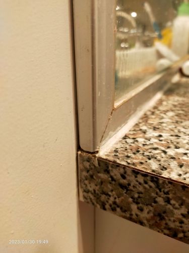

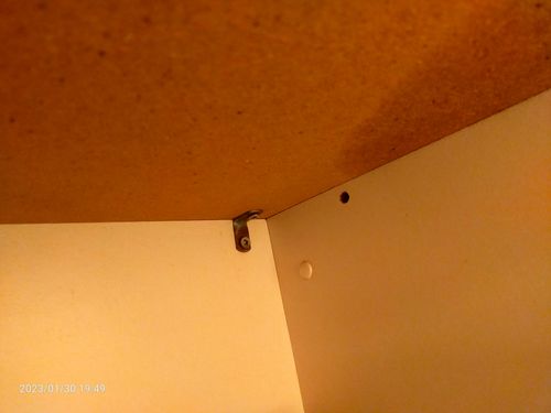

Thanks @MitchellMc . By the way, is it possible to remove the top without removing the mirror as the mirror is on top of the top (as per the photo below). Is there a glue between the mirror and the top I need to remove? I can see the screw inside underneath the countertop but not sure what else will be holding the countertop that I need to remove before removing the countertop

Hi @calccom21
Before attempting to remove the vanity top, please make sure to cut the silicone sealant between the mirror and the vanity top. I propose trying to slide the top out instead of lifting it so the mirror will not be stressed. For safety, I suggest covering the mirror with cardboard and masking tape just in case it breaks while you are removing the vanity top.
I suspect that your current mirror is glued into place. I suggest getting a professional handy person to remove it for you. It is extremely dangerous and there is the possibility of injury if the mirror is removed incorrectly. Please double-check all your measurements before making any attempt to remove your vanity top.
Please make sure to wear proper safety equipment such as work gloves, safety goggles and a dust mask when attempting to remove your vanity top.
Re: Bathroom mirrors and basin top
Thanks @EricL for the advise. Do you think it is just silicon between top and the mirror or is it glued to it? I'm trying to avoid moving the mirror. So thanks for the advise of getting cardboard to cover the mirror. Didn't thought of it
Hi @calccom21,
I would imagine that the mirror frame is not glued to the vanity top. It's likely just the white silicone caulk that needs to be removed. You can cut it away with a retractable knife. Remember to wear those safety gloves when you do and keep your free hand away from the blade whilst cutting. Also, remember to cut away from yourself.

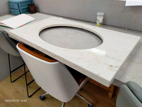

Thanks btw does substrate use underneath the stonetop same as MDF board? What thickness does it usually comes on?
Hi @calccom21
The best way to get that information is to speak to the manufacturer of your vanity top. It's difficult to guess how thick the timber board is underneath unless a side portion of the vanity top is exposed. Drilling into the timber board could possibly damage the finish of the vanity top if you accidentally drill into it. In this instance, I suggest just using silicone to keep the vanity top attached to the cabinet.
