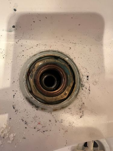

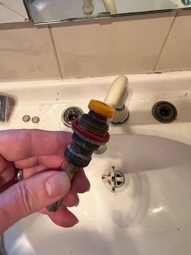

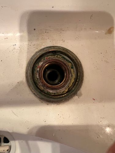

Hi Jason, please see the photos of my tap seat/washer issue.
Hi Eric, please see the photos of my tap seat/washer issue.
Hi @LeeBailey1975,
Repair tap seats are typically screwed in place with a tool. To remove them, you'd need to check the internals of it to see if a tool is used for removal. You can see the tools required for this HydroSeal Tap Seat Replacement Kit.
May I ask, before you attempt to remove the repair seat, where the tap is leaking from? Is it out of the spout or from the tap body?
The repair seat has likely been added due to a crack in the original seat. That crack might have worsened, allowing water to bypass the repair seat. If this is the case, you'd likely need a plumber to replace the seat for you.

The spout in the centre is leaking which leads me to believe it’s the tap washer seal. The seat has an ellipse type shape which makes me think it’s a seat insert. The ID is circular. Does a push in seat have a circular ID? I’m assuming a threaded seat insert would have a square shape internally to screw in and out.

Can you also please tell me what brass component is?
You can see on the Hydroseal version @LeeBailey1975, that the repair seat has tiny little indents internally to allow it to be screwed in with the allenkey. So, if yours is similar, the indents might not be particularly pronounced, and it might not be an obvious square or hexagonal shape internally.
You may want to consider a dome-type valve, as they can tend to seal more effectively. However, if the current valve is not sealing well at all, there's likely something else going on.
