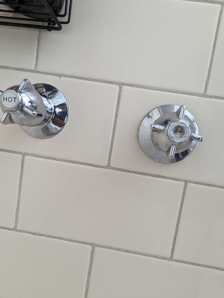

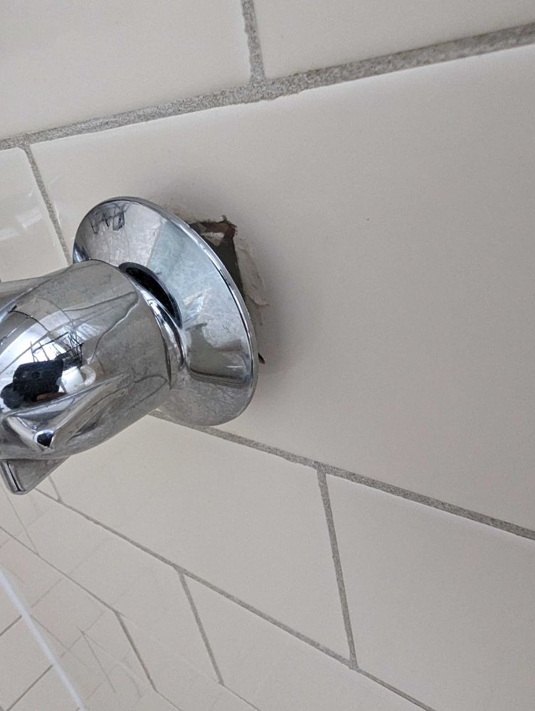

In my shower, the spring loaded flange for the cold water shower tap is loose and keeps spinning. To fix this , I am thinking there is something wrong with the spring.
In am trying to remove the tap and see what the problem is but I am unable to dismantle the tap.
I have tried using the spanner to open from the front ( is that correct ? ) but it slipping and seems to be damaging the tap.
I don't know what I am doing wrong here.
- How do I open this shower tap ?
- what is the likely cause of the loose flange ?
Any help much appreciated
G
Welcome to the Bunnings Workshop community @goks0. It's brilliant to have you join us, and many thanks for your question about dismantling a tap.
Check out this helpful guide: How to replace a tap washer. In step two, under the T-handle section, you'll see in the third image that the button needs to be removed with an adjustable spanner. This is the first step in dismantling your tap. Once the button is removed, the tap handle should pull straight off.
If the spanner is slipping off, the button is likely stuck. Try spraying some WD-40 over the button and letting it sit for a few hours. Try again with the adjustable spanner and ensure it is set on the tightest position whilst still fitting on the nut.
The spring has probably got caught up or is damaged. Is the cover flange loose, and can it easily be positioned back to the wall by hand? If so, you could run a bead of wet-area silicone around the inside of it and stick it to the wall.
