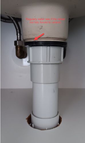

I managed to pull apart these components, please refer to these pictures below. Apologize for the grossness of the image :smile:
  • It looks like there is kind of silicon or glue being used to attach this chrome strainer into ceramic.
  • I will try to use knife to remove this silicon.
Apart of this issue, I am just wondering with the build of this plumbing system in my 2x bathroom (both are in the same setup) are normal / following a current plumbing/building code. Home was built in 2010, location Perth WA.
  • The chrome strainer is tied with a threaded bar where then a  rubber (40 mm diameter) attached to the edge to the ceramic basin.
  • Then all together are locked using wing-nut.
  • Few of Water leak if the rubber is not forcefully fastened to the ceramic basin.
and the final operational is as below, where an S-pipe attached at the end of the vertical pipe.
My plan is to replace this waste system with the one below, so there will be no more water leak between ceramic and S-pipe.

Re: question : How to remove Strainer Body/Basin waste from Bathroom Sink ?
Hi @daniel4
There's nothing there that would suggest those connections are not to code, but that's probably a question best posed to a plumber. If they are leaking then it would be worth replacing them. Please be advised that this is considered plumbing work and it requires enlisting the services of a professional to complete the work.
