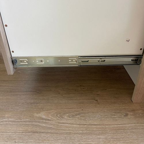

 How do I remove pot drawer? Others I’ve installed have a little latch to lift but these have none. Kaboodle installed 2019

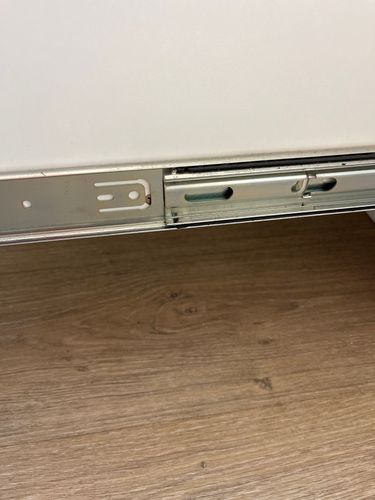

Is that the full extension of the drawer? If it is, the release clip of the older drawer runners are sometimes hidden in the runner itself. See if you can find a little window in the steel runner with a plastic clip in the middle. Should you find one, it needs to be either pushed up or down to release the runner.
Another possible spot is the interior third rail of the runner. You'll notice that the runner has a hidden third rail that is close to the cabinet. Look carefully and see if you can find a release latch hidden in the runner.
Can I also please request for a closer photo of the entire runner fully extended. This will give our members a chance to assess the mechanism. We can then make recommendations on how to proceed.

 thanks Eric. Pic of full runner attached

I suspect that it is that little pin that is sticking out in the middle of the drawer runner. You might need to push, pull or twist the pin in order to get it to release. The only other way is to unscrew the drawer box from the drawer runners.

I’m with @EricL mate that tab should move in some direction to release the drawer as the runners would have to have been fitted first then the drawer fitted. There should be a matching tab on the other side.
It should be possible to remove all the runner screws as they become exposed at various extension of length. There will most likely be a couple on the bottom. But since you know it’s Kaboodle, I would give them a call as they have a very helpful support service.
