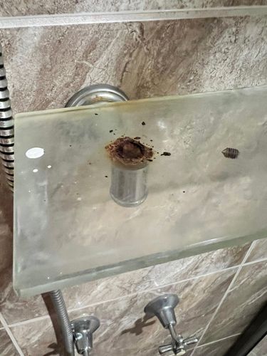

Hi everyone, do you know how to remove this glass shower shelf and its holders?
The nails screwed into the shelf from the top  are rusted and unsalvageable, so wouldn’t be able to approach dismantling from that angle…

There will be small round opening most likely on the underside of the posts adjoining the wall. These will have small grub-screws that will either be a small flat blade or less likely a Phillips head screwdriver fitment. But most likely an Allan key fitment to turn anti-clockwise. Just watch as you loosen each one to keep one hand on the shelf so it doesn't drop to the floor and shatter.

It's great that you've received excellent advice from @Nailbag. I totally agree with the recommendations made, if you can get a friend to help you hold the glass shelf while you remove the mounting screw at the bottom, disassembly should be much easier.

Thanks @Nailbag & @EricL. That’s what we thought originally as well and we’ve tried fiddling around in there with an Allen key, screwdrivers, turning it anti clockwise, etc but we’re guessing that due to all the gunk and corrosion buildup whatever’s in there has long since lost its original shape :unhappy:

If you are unable to remove the other grub screw @Icarus, the next step would likely be drilling it out to release the bracket from the wall.

If you decide to try @MitchellMc idea to drill them out, use a Cobalt drill bit which will be more up to the task. Just be careful not to bend it while drilling or it will snap.

Thanks everyone for your suggestions! We ended up having to call in the big guns cuz we couldn’t do it ourselves - my dad.
Dad ended up grinding off the rusted bolts off the top of the shelf to lift it off. As for the metal holding bits on the wall, they had tiny holes on the bottom and he used a torx screwdriver to get them out.
