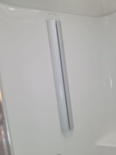

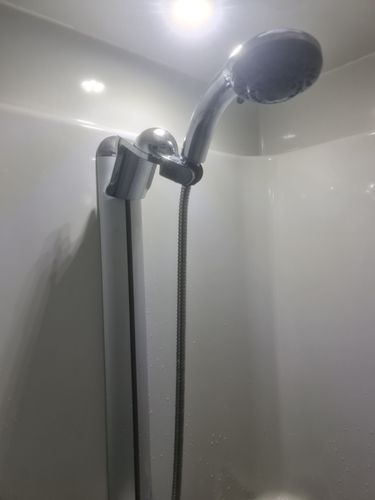

Hi all! I'm trying to replace a broken shower rail in my moulded acrylic shower. I've taken off the top and bottom 'knobs', but I've come to the conclusion that the main body of the rail is glued on as there are no screws. Please Help!! Does anyone know how I can remove the rail without damaging or breaking the acrylic?
The first photo below is before I took the 'knobs' off.... the second is the glued on shower rail that I need to remove.

Could I ask for some photos showing down the centre of the shower rail?
It certainly looks like there are no fixings that can be easily removed, but I'd like to completely eliminate the possibility before moving on.
If you look up or down the shower rail and around the perimeter, can you see any evidence of glue?
If you gently pull on the shower rail, does it have any give at all?
If it has been stuck on with adhesive, then using an adhesive remover like Goof Off could help, just make sure you test it in an inconspicuous location to ensure it does not negatively affect the acrylic shower before committing to its use.
Using a flat tool like a paint scraper to lever up the edge can also help.
If you can expose the glue, then cutting it with a utility knife will also help. Just remember to wear gloves, long protective clothing and eye protection to reduce the risk of lacerations.
Let me know how you go.
