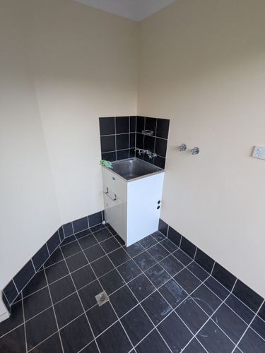

I'm looking to renovate the laundry and I'm hoping to replace the laundry cabinet and splashback tiles but keep the floor tiles and tile skirting. The waterproofing extends from the floor tiles behind the laundry cabinet and tile splashback. I expect removing the splashback tiles will affect the waterproofing directly behind it and the subfloor is a concrete slab. But is it possible to remove the splashback tiles without affecting the waterproofing under the skirting and floor tiles?
We're also looking to install hybrid floorboards over the floor tiles and raise the floor waste. The floor waste also has waterproofing underneath. I'm wondering if it's possible to raise the floor waste?
