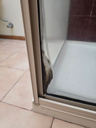

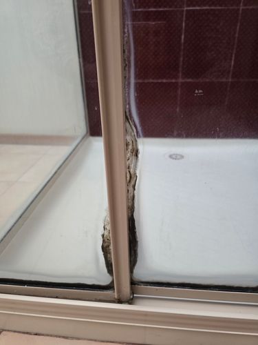

Is this corrosion or mould on the shower screen? Its a very old build. Is there a way to fix it?

I suspect that it is a form of mould that is interacting with the rubber and glass of your shower. If your shower door is made of aluminium, then it's highly unlikely that its corrosion. If you've tried to clean it off with mould killer and cleaning spray and it refuses to budge, I suggest using a Trojan Safety Scraper With 5 Blades. Please make sure to wear personal protection such as gloves, goggles and a mask when scrapping off the mould.
If the mould is trapped between the glass and the glass sealing agent there is not much that can be done about it as it is an inaccessible spot. the only option is to have the glass replaced by a professional shower installer.
